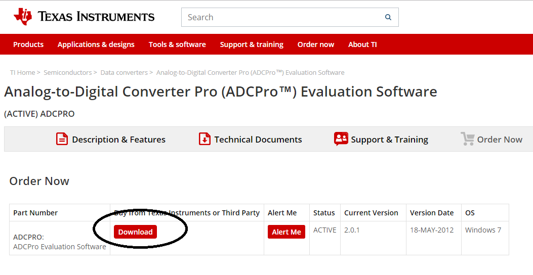

    The ADCPro installer is downloaded from here:
    http://www.ti.com/tool/ADCPRO
    The link shown above is the correct and only installer for ADCPro.  Ignore any usage to the launcher in the user's guide.  The launcher functionality has been removed.  ADCPro will work on 32 or 64-bit MS-Windows7.  ADCPro should be installed before the plugin.

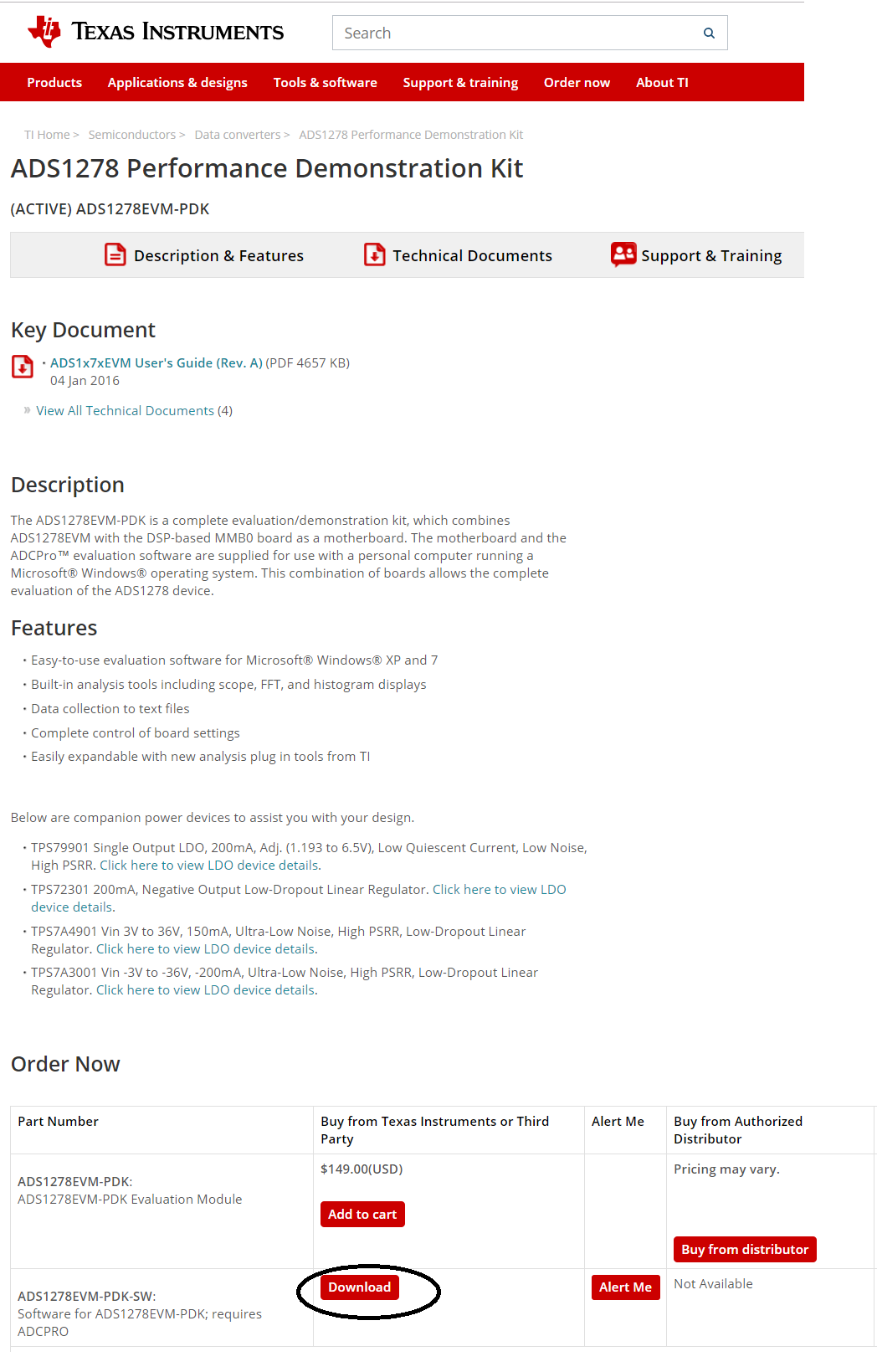

    The ADS1278EVM plugin can be downloaded from here:
    http://www.ti.com/tool/ADS1278EVM-PDK
    The drivers should be installed with the plugin.  The MMB0 is a motherboard to be used only for demonstrating the functionality of our EVMs.  It is not a development platform, and it is not supported in that way.  I do not recommend using third party tools or drivers.  ADCPro was developed for the Windows 7 platform. TI does not support ADCPro for Windows 10, however many customers have been able to get it to work.
    I would highly suggest you get ADCPro working on Windows 7, then once you see the entire installation process you can try to get it to work on Windows 10.  Here is another link that may be helpful.  It is not for the ADS1278, but you may be able to follow the instructions and get it to work.

    After downloaded ADS1278EVM-PDK-SW, my ADCPro and MMB0 worked together very well for both my Windows 7 and Windows XP.
    But, my Windows 10 still doesn't work with ADCPro and MMB0, although I restarted my Windows 10 with signature enforcement being disabled. After ADCPro was installed, Windows 10's device manager marked MMB0 as unknown. After I installed ADS1278EVM-PDK-SW, Windows 10's device manager still marked MMB0 as unknown, but I could see ADS1278EVM in the EVM tab of ADCPro. But ADCPro always says that "firmware download failed .. reset the firmware". After my pushing on the reset button on the MMB0 board, ADCPro tried to reload again, but always ended up with "firmware download failed .. reset the firmware".
