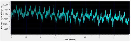

customer doing the waveform test on the ads1293 evm (previously they used and tested with ads1291
there is a test in the regulation with DC -300mV triangle wave input, but ads1293 output waveform doesn't meet the 10% distortion requirement.
ADS1293 EVM
input triangle wave 6.25HZ / Vpp=0.5mV / DC offset= -300mV  => FAIL.
the requirement is pk-pk can not have 10% error or 50uV. output below with IN 1 = input signal, IN 2 = GND

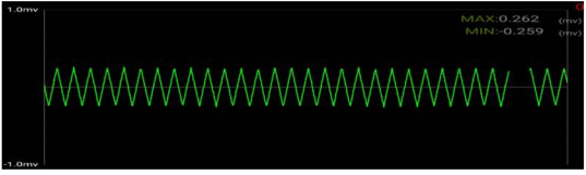

ADS1291 EVM
input triangle wave 6.25HZ / Vpp=0.5mV / DC offset= -300mV  => Pass.
Does the negative voltage signal input to the ADS1293, require more filtering? or it needs a negative voltage reference to the IC like the ads1291? (1293 is build in reference right?)

  • Hi John,
    Thanks for posting your customer's question.
    The issue is likely because the ADS1293 is only using a unipolar supply and cannot accept negative voltages on the input pins. Remember that the -300 mV DC offset is a differential offset. The absolute voltage on both input pins must remain positive.
    For example, if the unipolar supply is 3.3 V, IN1 can have a DC of 1.65 V (mid-supply) and IN2 can have a DC voltage 1.95 V. IN1 - IN2 will be converted as - 300 mV. Use the function generator to create a 0.5 mVpp triangle wave with a 1.95 V DC offset as the input signal for IN2.

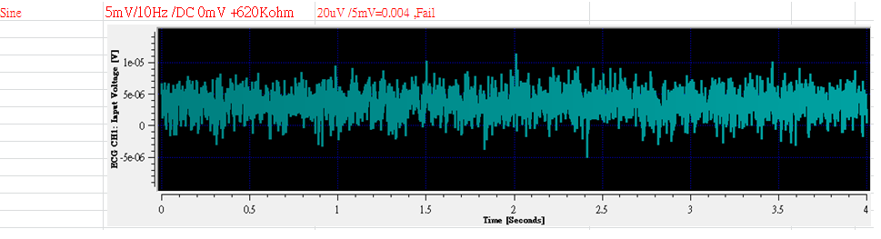

    another question, using  ads1293 to test regulation (201.12.4.4.102) input impedance, it needs to be >10Mohm. using 10Hz Sin wave , 5mV pk-pk to IN1. the output wave should not have more than 6% error.
    result 1: input sine wave 5mV 10Hz DC OFFSET = 0mV -> PASS
    result 2: IN1 add 620kohm, input sine wave 5mV 10Hz DC OFFSET = 0mV  -> FAIL
    it's tested that if the LEAD OFF ? bit is set. the result 2 output wave form will PASS. what might be the reason for the bit effect?

  • Hello John,
    John Chou62 said:
    customer checked with their regulation consultant. it appears that the input to IN1 and IN2 needs to be from 0V to -300mV. (can not be differential negative 1.65V to 1.95V)
    I believe the consultant is incorrect. Please see this related post where the IEC test setup for Input Impedance is shown. The +/- 300 mV is introduced by connecting switch S4 to a DC voltage source. This adds a +/-300-mV offset to the signal after the 620k || 4.7nF impedance. The remaining electrode inputs are shorted to the RLD electrode at P3. This sets the common-mode voltage of the input signals to the same voltage, typically mid-supply.
    Regarding the input impedance results, it appears that the lead-off detection current causes the system to fail the test. Please see my response edited on 02/09/18 in this thread.
