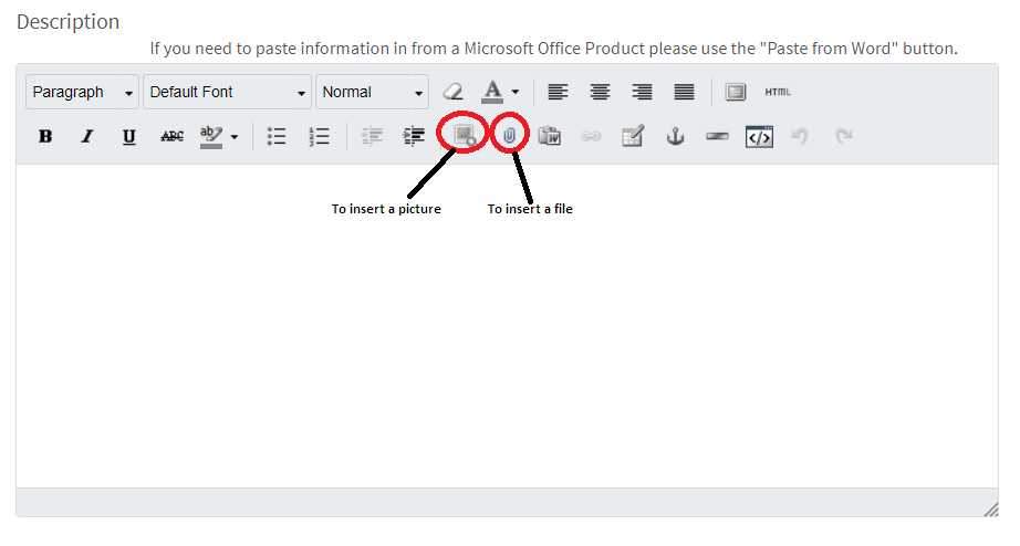

  • Hi Adnan,
    The pictures didn't come through.  Could you try reposting them again?  When replying make sure you select the Insert Code, Attach Files and more...
    And then select the appropriate icon to insert a picture.
