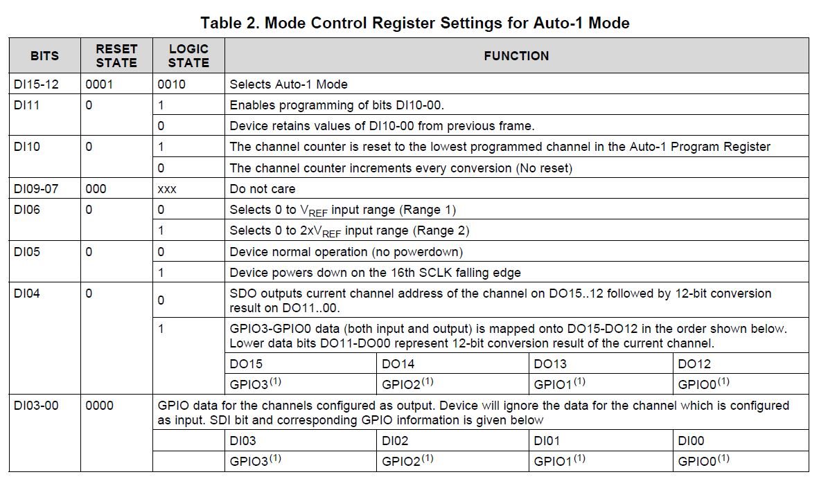

    From your post, it seems you are correctly programming the sequence channels, steps 2 and 3
    But step 4 does not seem correct. The first four bits, DI15-12 should be 0010 to select Auto 1 Mode. The command you are entering, highlighted below is actually to program auto 2 sequence.
    4. (CS High to LOW)  1001 0000 1100 0000 // Enter and configure AUTO1_PRM REG for CH0,1,2,3
    Please refer to the below table from the datasheet for how to enter Auto1 mode after configuring the sequence.

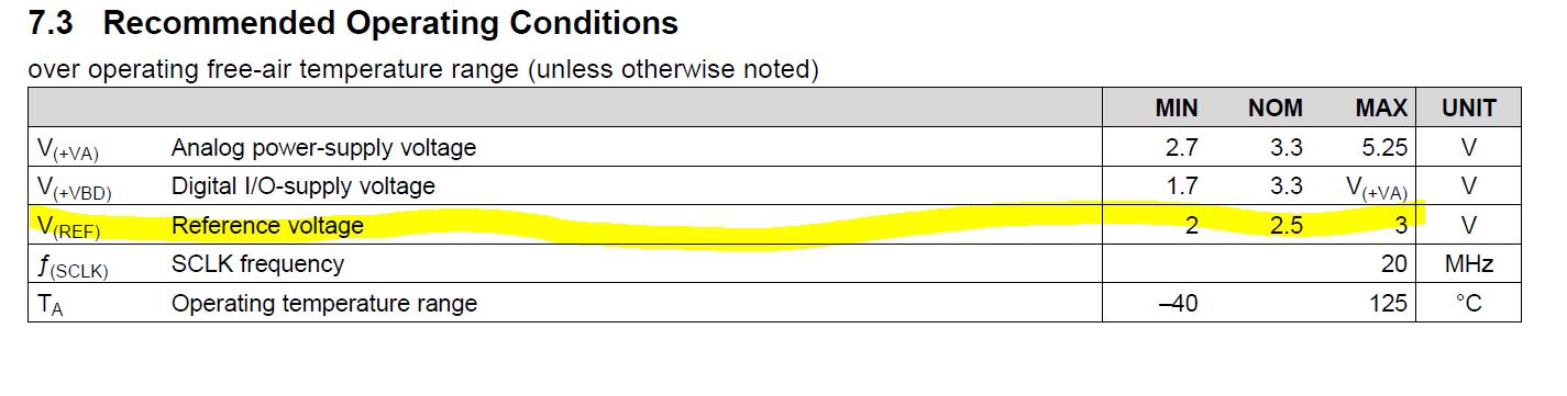

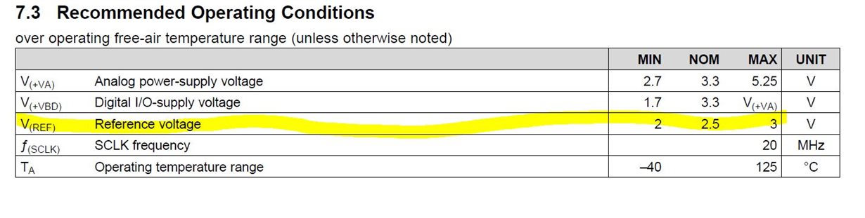

  • Vamsi,
    This device is meant to be used with a 2.5V external reference, at your current level you are not meeting the minimum spec outlines for the device.
    When debugging, to make sure that the digital communications are correct, Connect a scope to the digital lines can elp visually verfiy that is expected to and from the device is actually what is going on. you can use this scope shot to compare versus the table to make sure it is correct. make a special note of the bit DI10, as this should be 0. if not then the channel will always be the lowest channel count, in your case, channel 0. This can also help verify the digital timing in case there is any issues with that.

    For auto 1 mode, looking at your steps from your original post,  please try the following:
    4. (CS High to LOW)  0010 1000 0100 0000 // Enter and configure AUTO1_PRM REG for CH0,1,2,3 ( enable programing, channel counter increments, 2xVref range, normal operation, show channel number of SDO upper 4 bits
    5. (CS High to LOW)  0010 0000 0000 0000 // Enter into Auto1 mode
