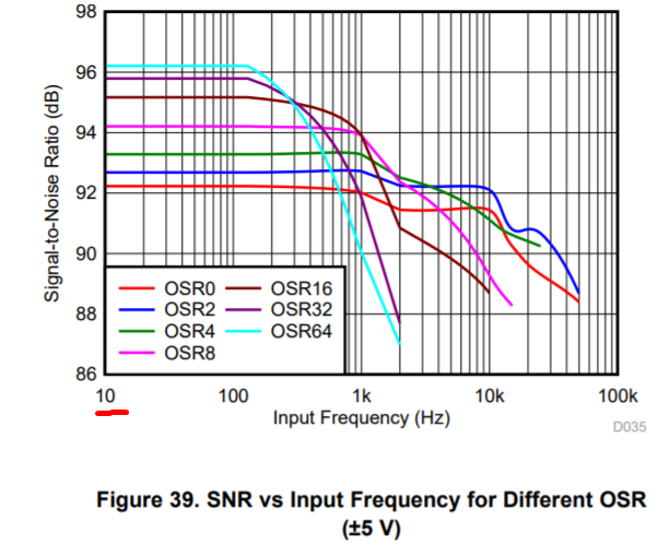

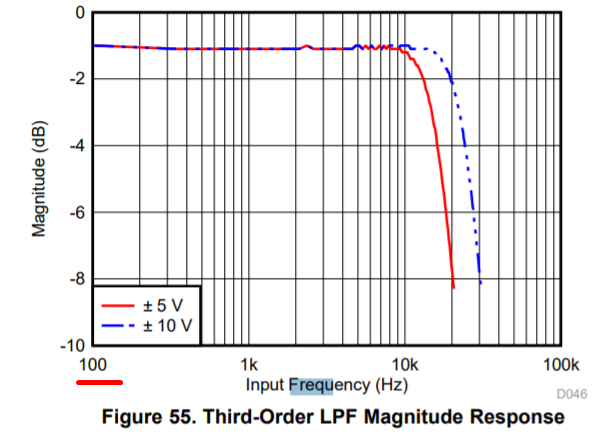

I am developing a low frequency acquisition system, [0.5 - 40] Hz bandwidth and I am thinking to use the ADS8588H as my ADC, but reading the datasheet I found some graphs that concern me because at low frequencies they seem problematic. Additionally, most graphics in the datasheet, including the filters, show the frequency response from 10 Hz and beyond, never below 10 Hz.
Could someone tell me if this is really a problem? why those graphics are that way at low frequency? and why some others don't show frequencies below 10 Hz?

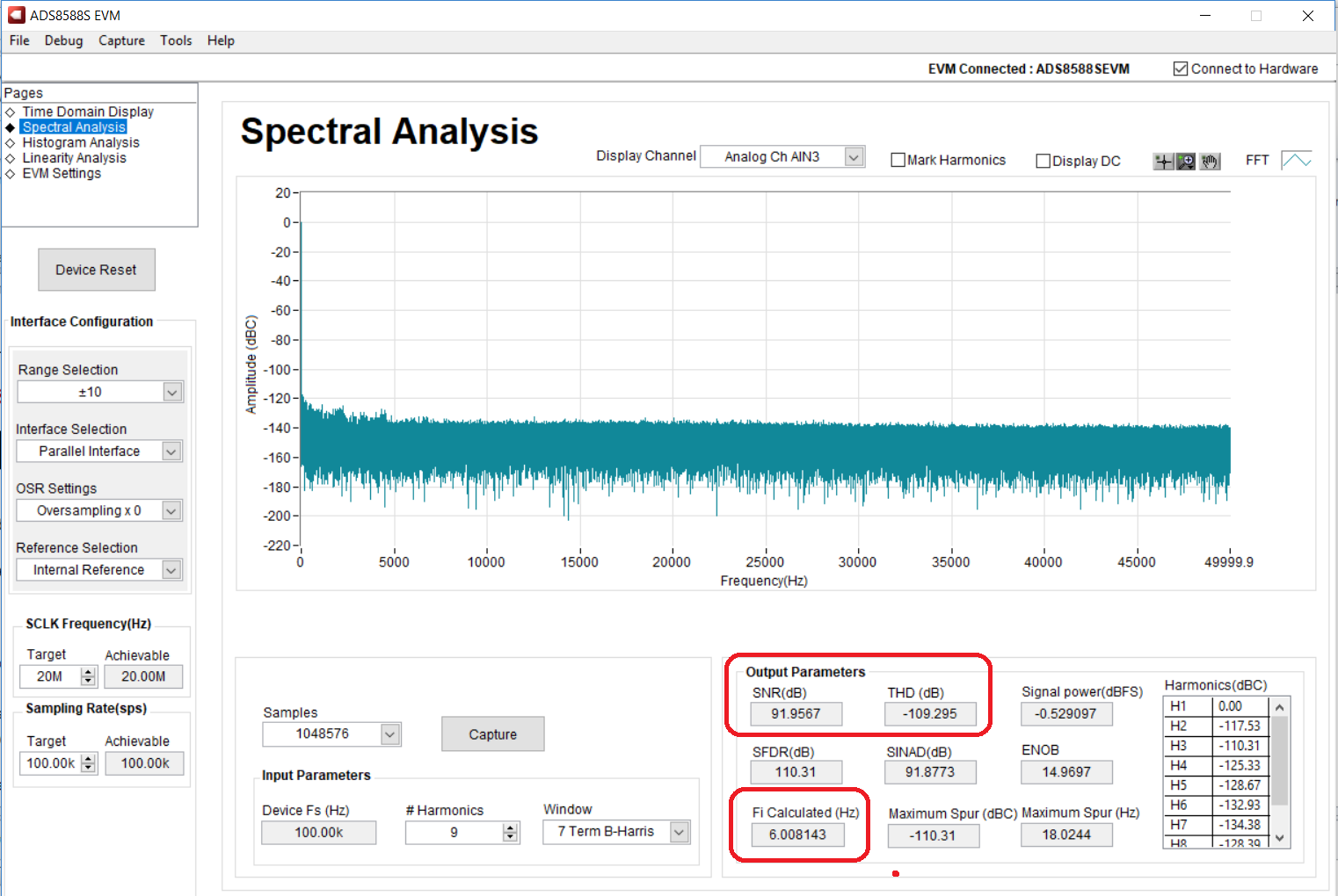

    Usually the ADC's AC performance(SNR and THD) is considered for AC input signal and its harmonics, your input signal frequency is really low (0.5Hz) and it's close to a DC signal, hence this requires huge samples to calculate AC performance especially if your ADC's sampling rate is high. I did the test with lower frequency(6Hz) input sinusoidal wave signal on ADS8588SEVM, please refer to the screenshot with the detailed information as below, the SNR and THD are close to the specifications in ADC's datasheet:
    Dale

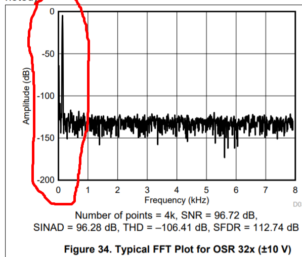

    So you think that there is not any problem with the device at low frequency (0.5Hz)? , just because of the bins, huge samples are needed to calculate AC performance, so that's why they don't show low frequency (<10Hz)? and why is there a graph with so many peaks at low frequency (Fig 34)?
