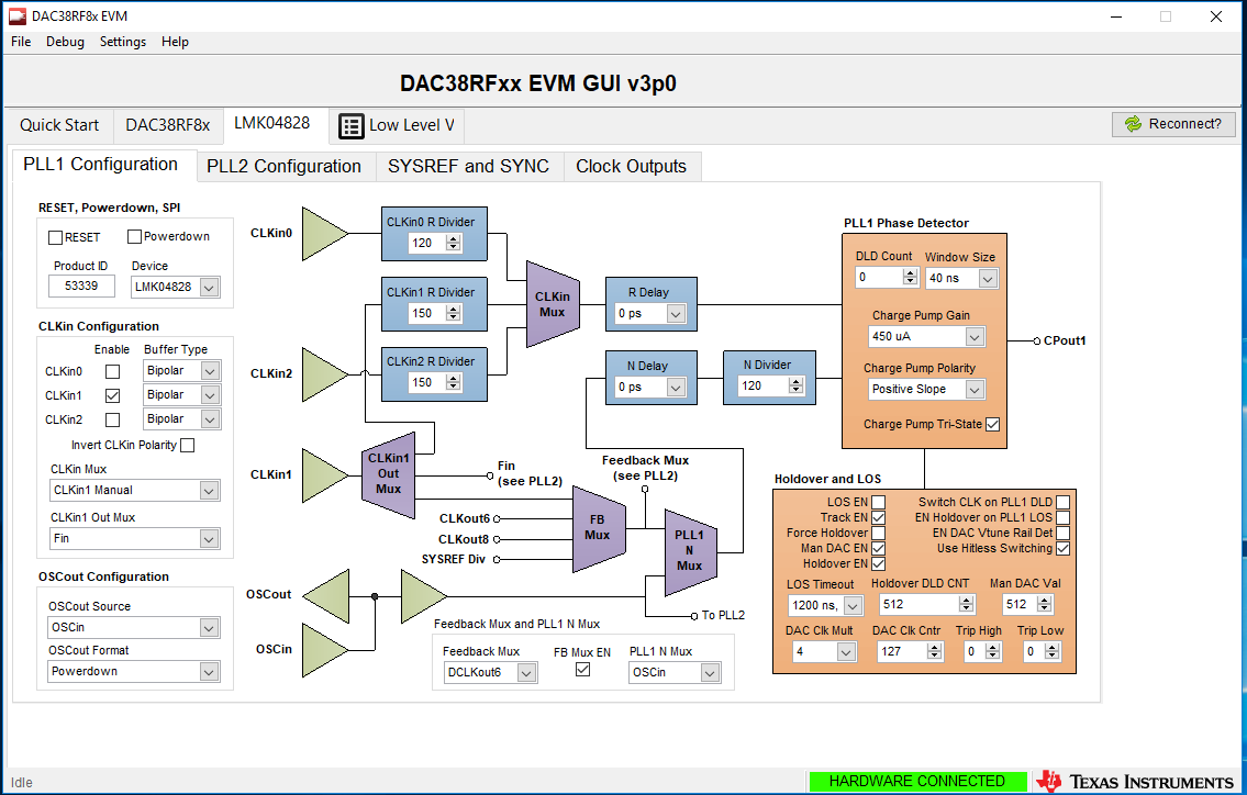

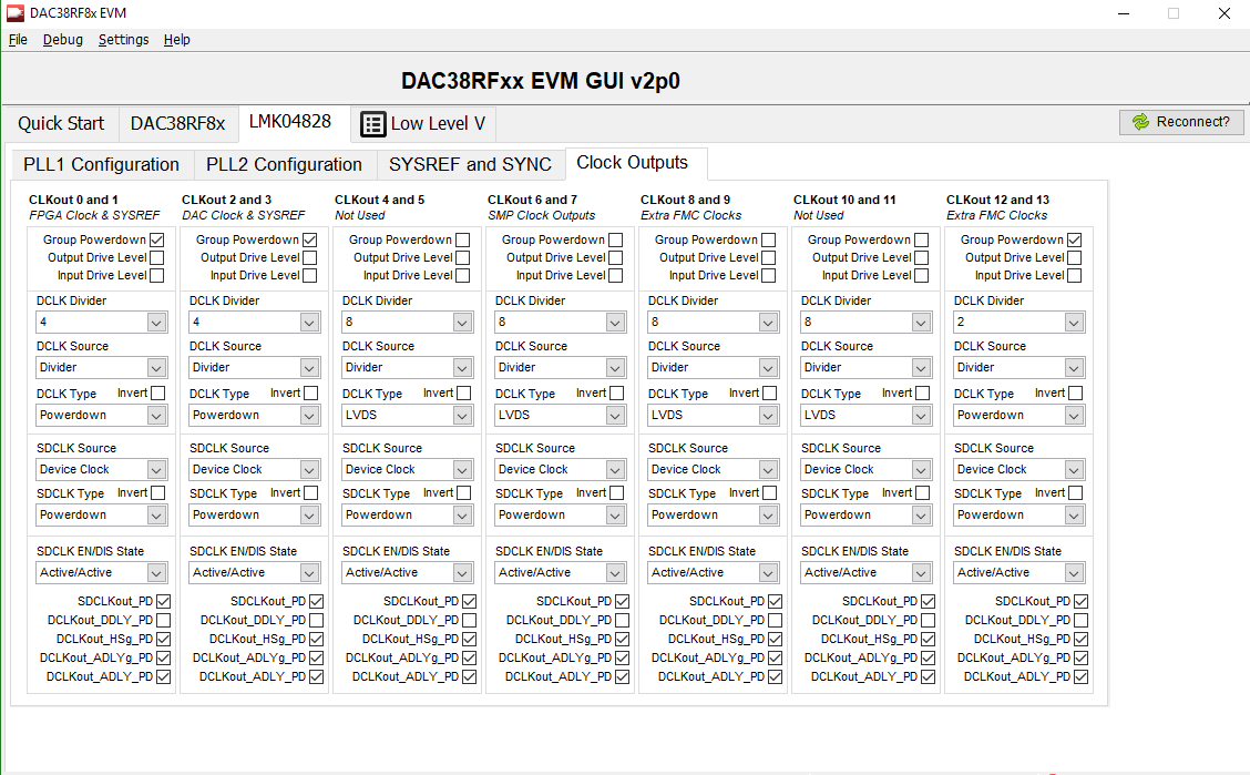

Currently, I am trying to configure the various output clocks at our disposal from the LMK04828 clock synthesizer/jitter cleaner and am having a few issues. I've attached a screen shot of the GUI page where I believe the issue may be occurring:
I've been trying initially to produce an output at CLKout 4 since that is connected to SMA J24 just to verify the LMK is working properly before hooking up our FPGA. So far, I have been able to produce an output signal. I've made to sure to uncheck the "group powerdown" checkbox and adjusted the settings seen above. Am I missing something?
I have an input clock at the DACCLK+/- but currently don't have the LMK CLock input at 1/4 of the DACCLK sampling freq. Would that be why, or does something else need changed or some other action have to take place?
Jared

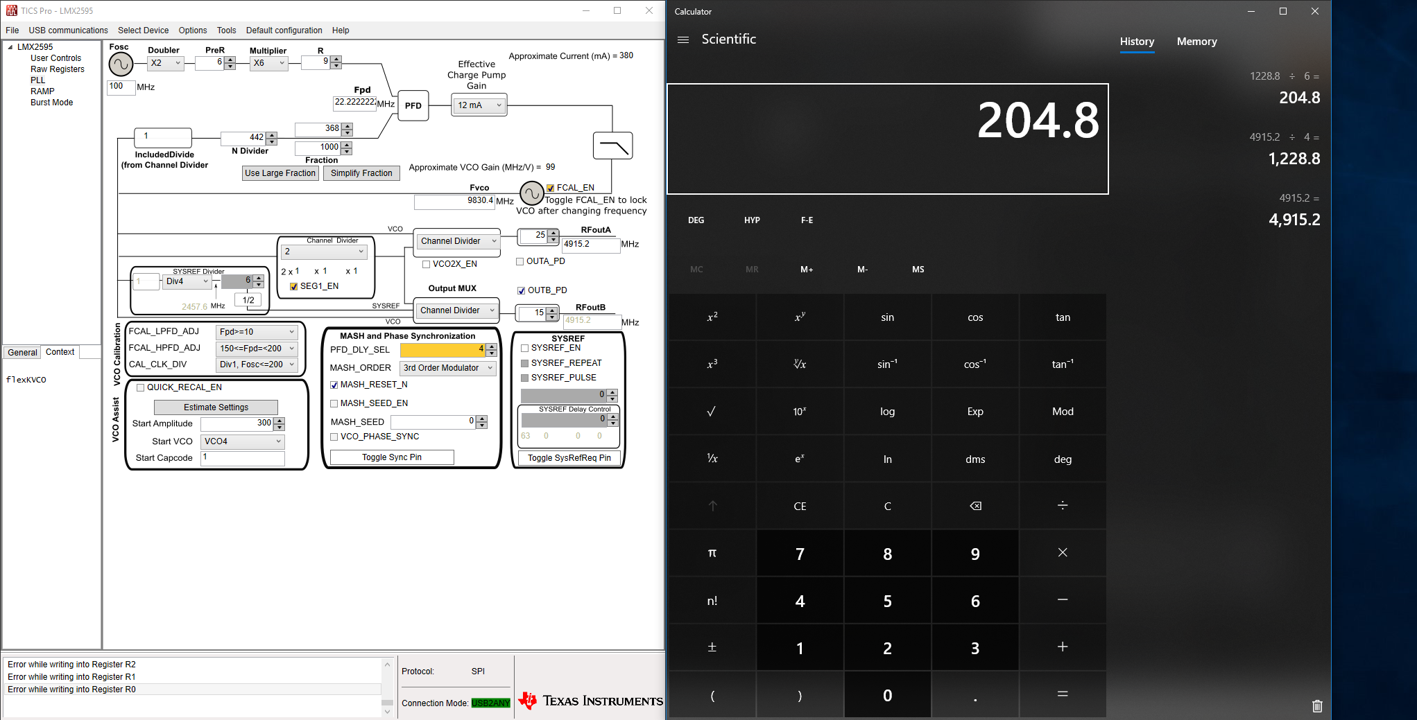

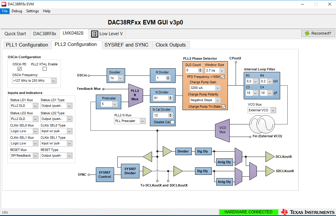

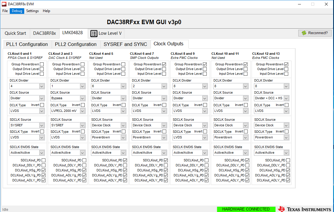

    Here are the screen shots of the LMK configurations in the DAC EVM GUI along with my clock setup for the LMX2595:
    I believe I have everything set up correctly for clock distribution mode. I configured the DAC to operate with a clock of 4915.2 MHz (default value). So then when it gets divided by 4, I should get an Fin frequency of 1228.8 MHz into the LMK. Then I have DCLKOUT turned on and have the divider set to 6. The frequency I am getting at that SMA however is roughly 350 MHz despite expecting 204.8 MHz. I've tried other divisions, and the math isn't working out for any of them. Am I missing something?
    Jared
