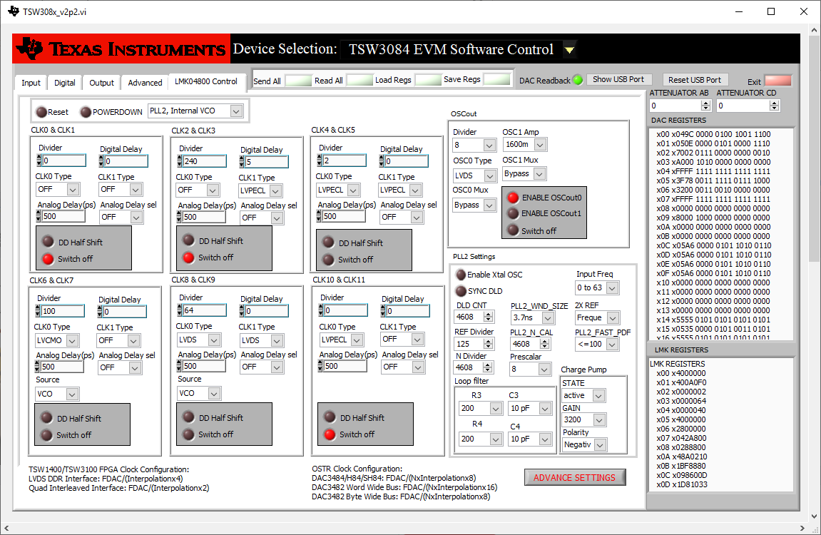

I am working on a LabVIEW program to download the configuration files to control TSW30SH84EVM. There is an available FTDI LabVIEW program to do this, but the program uses a different format. As there is no document to explain how to convert them, I hope help can be found here. Two documents are attached, one is the configuration txt file and the other is the FTDI example txt file.

LMK REGISTERS

ATTENUATOR AB
0.00
ATTENUATOR CD
0.00
Write

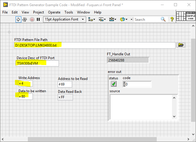

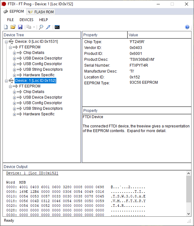

    2) How can write data to the device? Here are the steps that I follow:

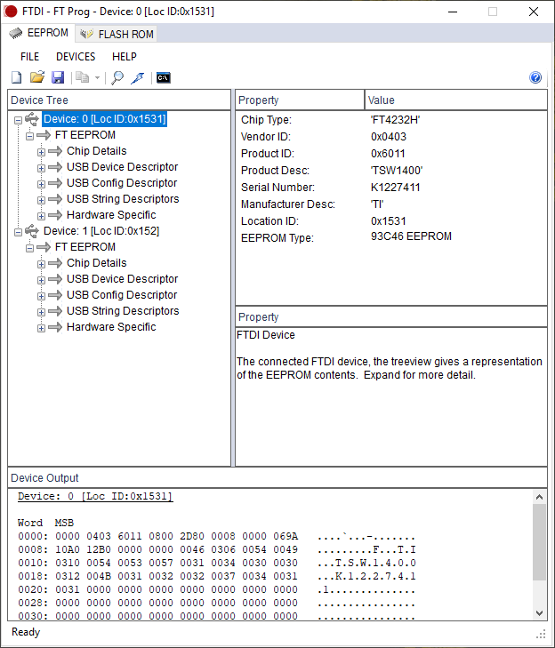

    a. check the device with FT_Prog.exe to make sure the name of the FTDI port. I can see 'TSW308xEVM' and 'TSW1400'. I choose 'TSW308xEVM' which has LMK04800 and DAC34x84 integrated.

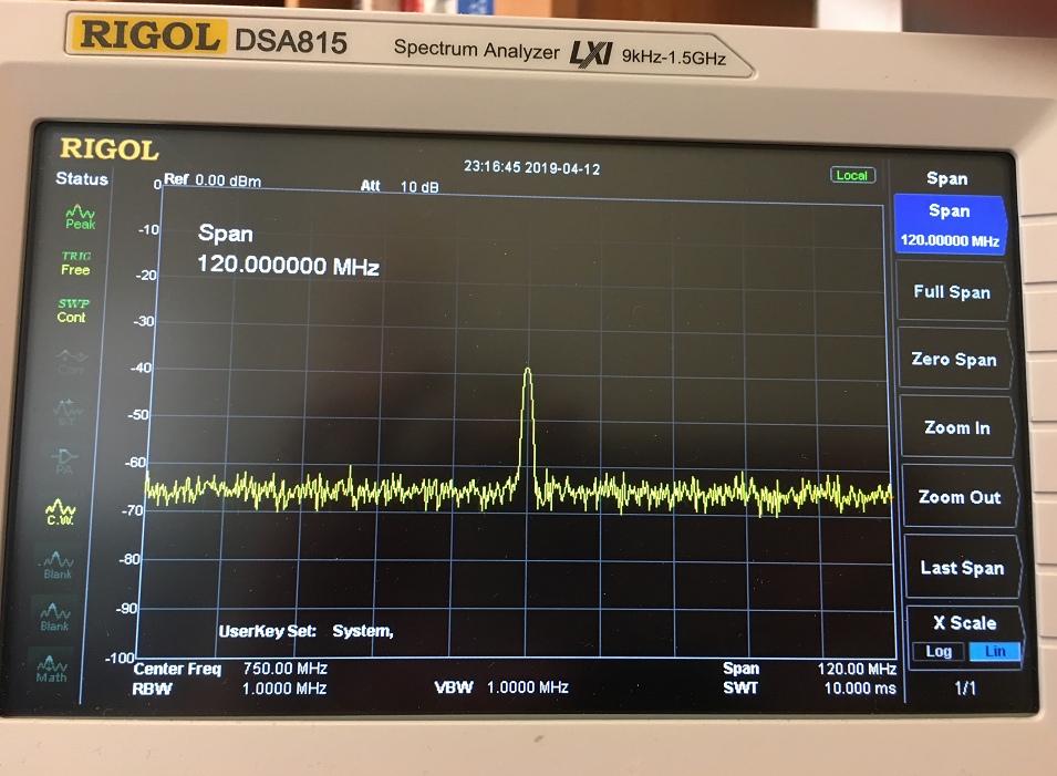

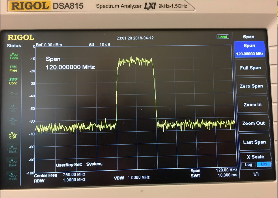

    b.I run the GUIs and generated the desired waveform shown below using internal VCO.
    c. To prove that I can talk to the device. I turned off the GUIs and load the LabVIEW program provided by TI. I want to change the current Clock8/9 divider from 64 to 128 (which can change the sampling rate), and I know the required LMK registers is 'x04 x0000080', so I put the write address to 'x4', and data to be written as 'x80', the FTDI pattern file is the text file shown in 1, the device Description is 'TSW308xEVM'.
    d. However, the result is negative. The desired waveform is disappeared, as shown below.  I am not sure what I did wrong, or am I messing something here.

    I am not sure what you mean. The purpose of the Labview DLL is to write the SPI data to the DAC or the LMK. The FTDI FT_PROG is to program the USB ID for different FTDI chip identification.
    The TSW1400 that you are using has a reference clock that needed to run the firmware fabric. You will need to set the correct clock frequency for the correct operation based on the data rate and interpolation.
  • Hi Kang,
    The very basic question is how to send a DAC register or LMK register using the Labview DLL, for example 'x04 x00000080' to LMK04800, s shown in the figure below. It looks right but it does not work.
  • Fuquan,

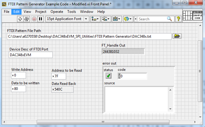

    You have the right idea. For the LMK04808, you can find some default registers to read back to confirm correct values and change it and re-verify. we do not support LMK04808 products here in this forum.
    Here is an example snapshot of the DAC348xEVM with 0x7F register read back.
  • I realized that there are some differences.
    1) The model used in my setup is TSW30SH84 EVM, which has DAC34x84 and LMK04800 integrated, but the one shown in your screenshot is DAC348xEVM.
    2) The FTDI pattern file I am using is for DAC34x84, so is there a special version for TSW30SH84 EVM.

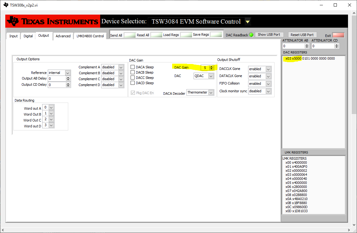

    Here is another example that I am trying to control the DAC gain, the corresponding DAC registers is 'x03 x5000', which set the gain to 5 dB. However, the output is turned off if the LabView DLL is used, as the picture showed below. I would guess the FDTI pattern file is not correct.
  • Hello Fuquan,
    I will have to check on the TSW30H84 EVM and get back to you. I do not have one in the lab, so need to order one and test it out. There is a CPLD in between the FTDI chip for SPI bit-bang and the actual DAC34H84. I suspect there could be a firmware issue or something.
    I recommend that you probe out the SPI lines of DAC34H84 (refer to the TSW30H84 schematic and check for SPI timing and the proper return of data, especially known registers with valid bit output)
    -Kang
