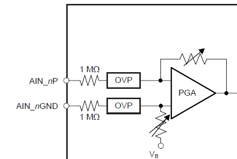

My customer uses ADS8688 and LM35DZ (temp sensor). ADS8688 convert analog data from LM35DZ. Temperature slope of LM35  output is 10mV/ degree C from 0mV.
When user connect the output of LM35 to ADC8688, the output of LM35 will not be under 0.1V at low temperature.
Once he checks LM35 without connection to ADC8688, the output will be close to 0V at low temperature. I believe the output may clamped by ADS8688 input. Because Input of ADS8688 may have internal 1Mohms and OVP. But do you have idea how to release the clamp?

    ADS8688 has an internal bias voltage (VB: ~2.25v for +/-2.5Vref input range), when there is no input signal (disconnected), the bias voltage will show up, but if there is an available input signal to the ADC, this bias voltage will not appear and the ADC's output will be the conversion of input signal.

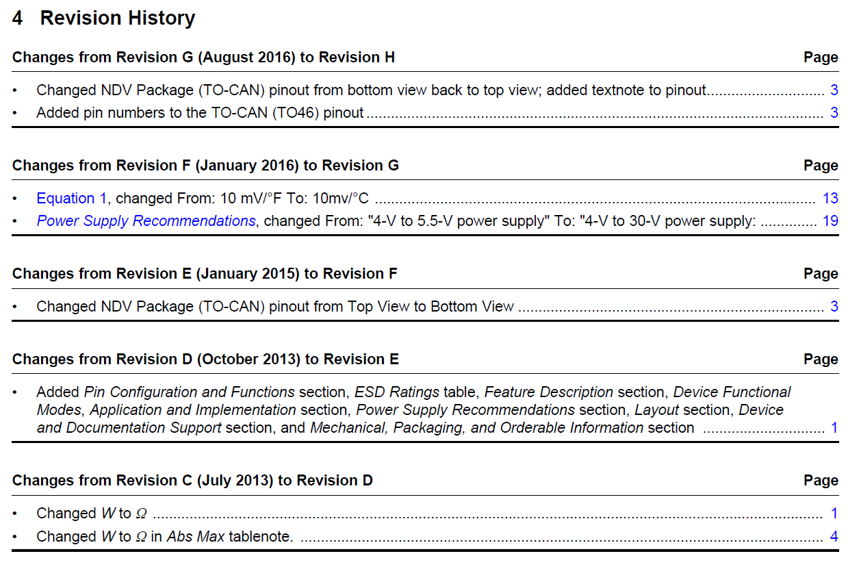

    Definitely there is a relationship between LM35 and the circuit. Can you please remove TVS to check? Also, can you please let me know which version LM35 the customer is using? thanks.
    Dale
  • Hi, Dale -san,
    Thank you for your support. I will check if the state would change without TVS. But why do you need the revison of LM35? As I check the revision history in datasheet, I could not find specific item to care for this. Unfortunately I have no idea how to get the revison from LM35 customer use. So, could you please let me know which charactoristics are required in LM35? I will ask them to LM35 BU team.
    Nagata.
  • Hi Nagata.
    There are LM35,LM35A, LM35CA,LM35C and LM35D,they have different specifications. I want to know which is right part you are using and I want to check the detail about the device. Thanks.
    Dale
  • Update: communicated with Nagata offline because of LM35 from different team, the issue has been identified, the reason why the customer could not get conversion result less than 0.1V is, LM35 has one large output impedance(R2+0.125R2) on the output, it created a offset voltage with 1Mohm input impedance on ADS8688 when LM35 is connected to ADC's input. The query will be closed because it has been identified. Thanks.
