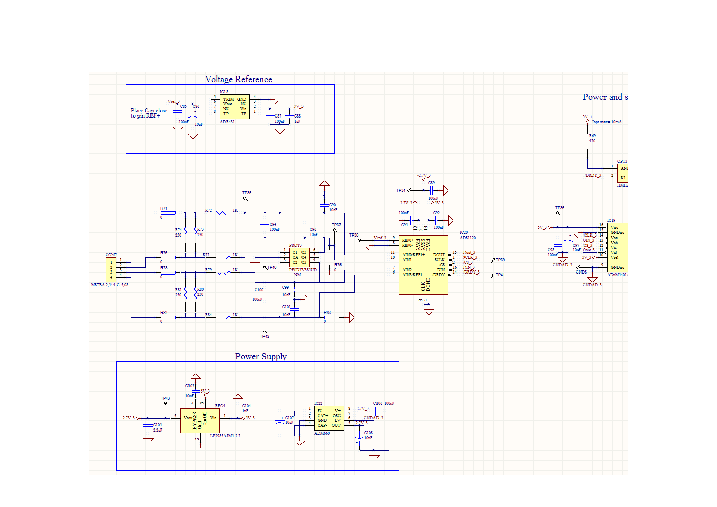

I use the ADS1120 to realize measures between ±20mA.
The equipment has 8 cells with one ADS per cell. This cells are isolated between itself.
In many of this cells the funcionality is Ok, the componente work well.
But in the last production i see 6 componentes that have a compression mistake in negative measures, only, and near FS.
One of the test is a curve for test the lineality of input. I put in the inputs, values between -20 and 20mA with 1mA of step.

  • Hi David,
    Yes it would be helpful to see the schematic and also to know the register settings being used. The linearity is shown in the datasheet in the electrical characteristics table on page 7. Typical INL is 8ppm of the full-scale range (FSR) and worst case of 20ppm. The linearity is also shown graphically in Figures 7 through 10.
    Depending on your FSR you may see some variation but not the degree of variation you are showing. As I do not know the reference voltage, gain settings or specific information regarding your setup I cannot give a precise value.
    The only time I have seen an issue with linearity is when the input voltage not within the correct common-mode input range, or if large series resistors are used for input filtering.
    Bob B
  • Ok. I add the cell of on analog input.
    The registers settings are following:

    The supply voltage is 2.7V and the external reference is 2.5.
    The input is 20mA, that in the ADC input is 2.5 volts.
    The serial resistors are 1k, is it possible that are large?
    Is it preferible 100?
  • Hi David,
    I didn't get the picture/drawing you attached.  Make sure you follow the following directions when attempting to insert pictures or files:
    Reviewing your registers settings you have set the device to Turbo mode so that the data rate is running at 2000sps.  You are using PGA enabled at a gain of 1, which restricts the common-mode input range as given in section 8.3.2.1 of the ADS1120 datasheet on page 22.  You have also set the digital filter to simultaneous 50/60 Hz rejection which only works in normal mode at 20sps or duty cycle mode at 5sps.  So when operating in turbo mode this setting is ignored.
    With the ADS1120 powered by 2.7V, with PGA enabled and using a gain of 1,  the common-mode input range becomes 0.675V < AIN < 2.5V.  It is not clear how you are connecting the inputs to the shunt for the current to be measured.  1k series resistance is fine to use, but the actual input voltage relative to AVSS and AVDD are very important as this input voltage must be within the common-mode input range defined above for a 2.7V unipolar analog supply.
    As the measurement is showing a relative input voltage from 1.25V to -1.25V means that the AINP input moves about a voltage that has a range of 2.5V.  Normally you would have a fixed voltage for AINN that would allow this measurement range.  If the input for AINN is connected to 1.25V, you can input a voltage to AINP that can range from 2.5V to 0V.  As the measurement is relative to the voltage at AINN, an input voltage at AINP of 2.5V gives an output code value of 1.25V and if AINP is 0V, the the output code voltage value is -1.25V.  However this input range is only valid when the PGA is disabled and bypassed.  With the PGA enabled you are restricted to an input voltage at AINP of 0.675V to 2.5V, otherwise you would be in the non-linear range of the PGA.
    If your system is connected similar to as how I've just described, you should disable the PGA to allow the full measurement range desired.
    Bob B
  • Hi Bob.
    Yes, the analog input is conected for that FS are 2.5V os -2.5V. with a resistor to change the current (20mA) to voltage(2.5V).
    Ok. I change and disable PGA for this design. And I'll testing de equipment.
    But if i need add a gain with ADC. is it better change the operating mode and put a normal mode?
    Thank you.
    David.
  • Hi David,
    Could you try attaching again by using the paper clip icon (to attach a file)?  The insert media icon is looking for a picture file like .png, or .jpg. files. Unfortunately you can not drag/drop or copy/paste pictures or other files and must click on the appropriate icons to insert pictures or files.
    Operating with PGA disabled you can achieve gains of 1, 2 or 4.  If you need gains greater than 4 you will need to have the PGA enabled and make sure the input voltage is within the correct common-mode range.
    There is no difference in the operation between the normal mode and turbo mode with respect to the operation of the PGA.
    Bob B

  • Hi Bob.
    The change is OK.
    Thank you.
