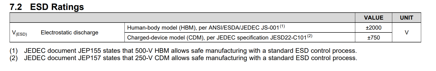

    The device pins for the ADS1148 are tested and pass the ESD ratings as shown in section 7.2 of the ADS1148 datasheet shown on page 7.
    These ESD ratings are not the same specifications as used in the IEC impulse noise tests.  It is difficult to say if there is one device pin that may be more sensitive than another.  The best approach would be to treat each pin the same way.  If there is not enough board space you would need to treat the most sensitive inputs based on the information I provided in my previous post.
