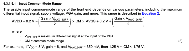

I had a difficult time understanding the way the data sheet was presented and I just wanted to make sure my understanding was correct.
If my Vmax_diff was 0-2.5V with a Vdd=3V, Vss=0 and a PGA gain=1, setting my CM to 1.25V this would cause the output of the PGA to saturate at the correct conditions correct?

  • Hi Colleen,
    This may have already been communicated to you offline via email, but I will post the reply here as well just in case.
    If you set the common-mode to 1.25 V you would be out of the CM range with a 2.5 V maximum differential. The equation is saying the PGA output requires 200 mV on either side of headroom which means 2.5 V would only barely fit in there.
    Using the internally generated mid-supply RLD voltage helps keep you in the correct range. It can also help with common-mode rejection as explained in this app note.
