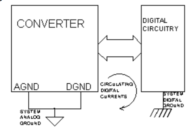

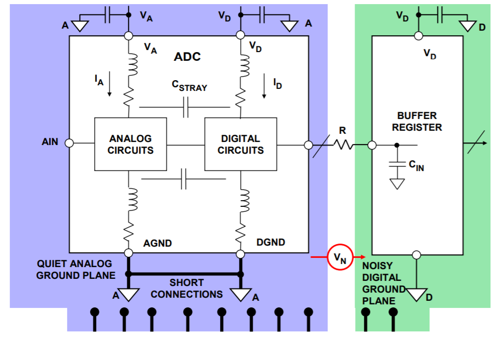

I am using 8 channels, in parallel mode configuration and operation in the ±5-V input range. I have noticed that this particular ADC doesn't have what is call DGND, I am guessing is because normally is recommended to connect AGND with DGND. I am thinking to use a grounding technique call "Split Ground Planes Connected at System PS", as shown in the attached file, but what concerns me is that the datasheet of this device says "Using a single common ground plane is strongly recommended. For designs requiring a split analog and digital ground planes, the analog and digital ground planes must be at the same potential joined together in close proximity to the devices".
so my question is:
How to use a grounding technique, as the one mentioned, if the data sheet obligates me to connect the analog and digital plane directly?
taken from: https://www.analog.com/media/en/training-seminars/design-handbooks/Practical-Power-Solutions/Section3.pdf
