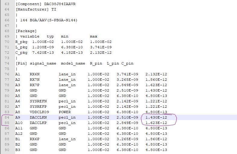

Datasheet says DACCLKP/N input capacitance is 2pF. Does this mean 2pF is connected between DACCLKP and DACCLKN or between pin to GND have 2pF each?

Watanabe-san,
The datasheet is inferring a differential 2pF.
The most accurate (and measured) model will be the IBIS Model
For the DACCLK input, we have the following parameters
The RLC model can be extracted from the following diagram:
http://www.ti.com/lit/an/snla046/snla046.pdf
