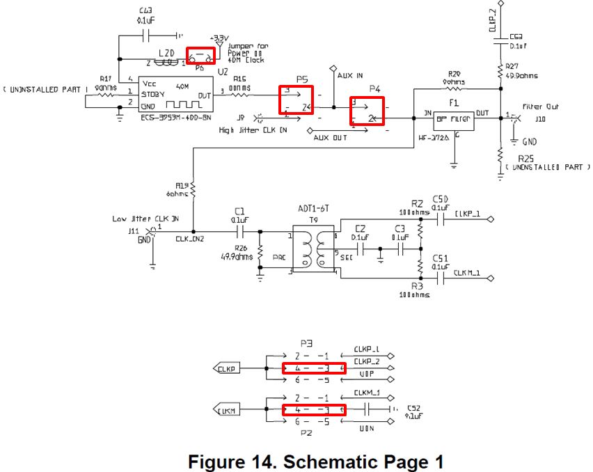

  • Hi Chen
    I have a TCXO oscillator which generates sine wave and this is buffered through an analog buffer PL133-37 and sent to all three afe5801 adc as single ended clock input with clkm grounded via 0.1uF cap , with this sine wave clock we see that ADC outputs is always zero , then we understood from datasheet that sine wave has to be sent via capacitor , we tried this by lifting buffer output pin and connecting a series capacitor from pin to pad so that clkp of afe5801 gets clock via capacitor since it is sine wave , what should be the capacitor value to be used to make sure adc always works , since adc expects clkp series capacitor very close to it but we are putting it at buffer output
  • Hi Akshay,
    Please look at and refer to the AFE5801 Users Guide:
    "Figure 14. Schematic Page 1"
    P3's 4-3 only
    P2's 4-3 only
    P4's 3-2
    P5's 3-2
    P6 is shorted.
    Hope this can help.
    Thank you!
    Chen
  • Hi Akshay,
    How are you?
    Here is the schematic showing how we connect clock as single-ended input.
    Please take a look:
    Thank you!
    Chen
