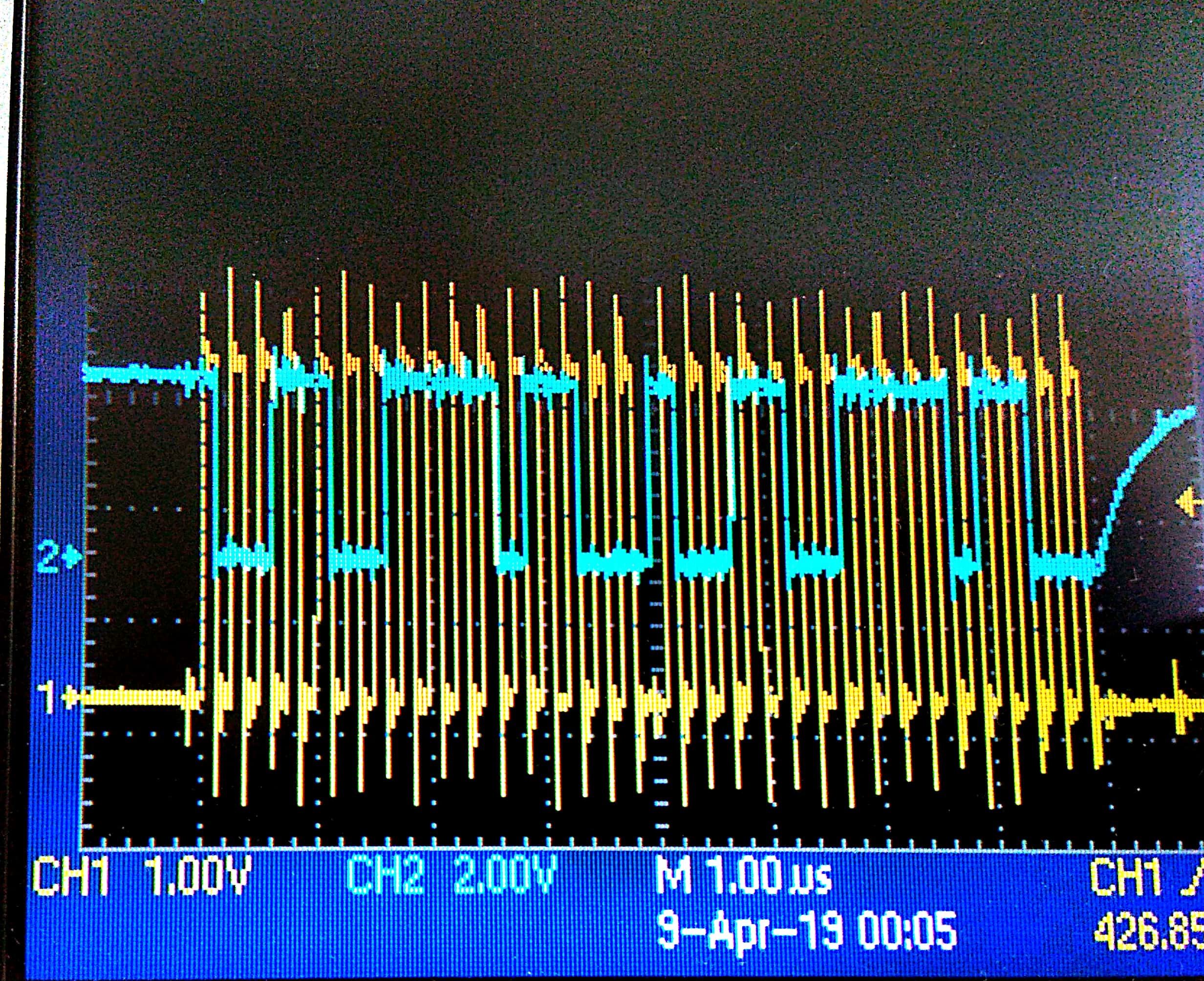

  • Sir,
    I have ADS8681EVM also. I am not finding the way to capture single Write Cycle / single Read cycle to correlate and correct my micro controller interface. Pls suggest

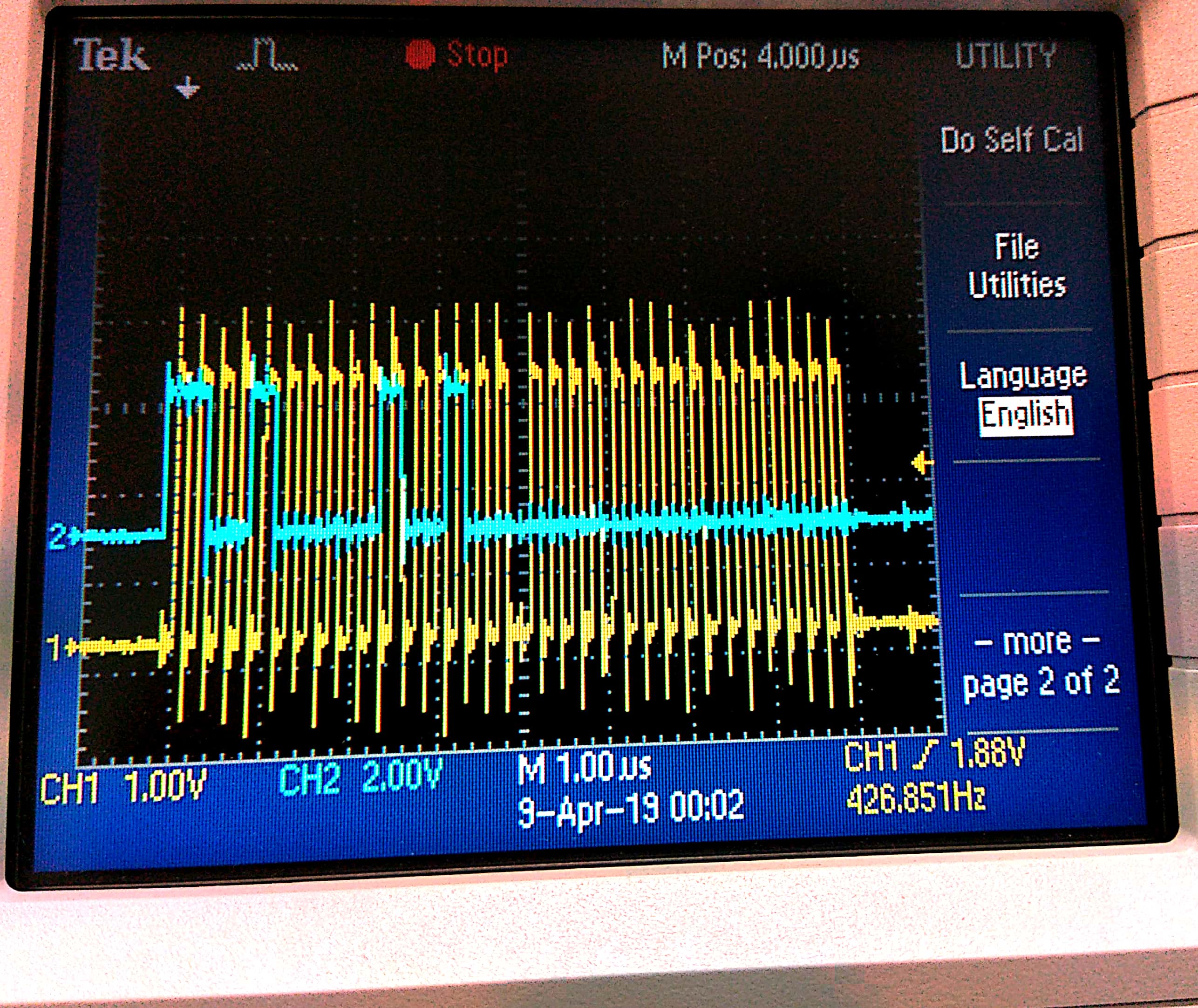

  • I want to update further based on your suggestion,
    I do not have logic scope, capturing via CRO.
    My microcontroller supports 16 bit SPI transaction, 32 bit not available.

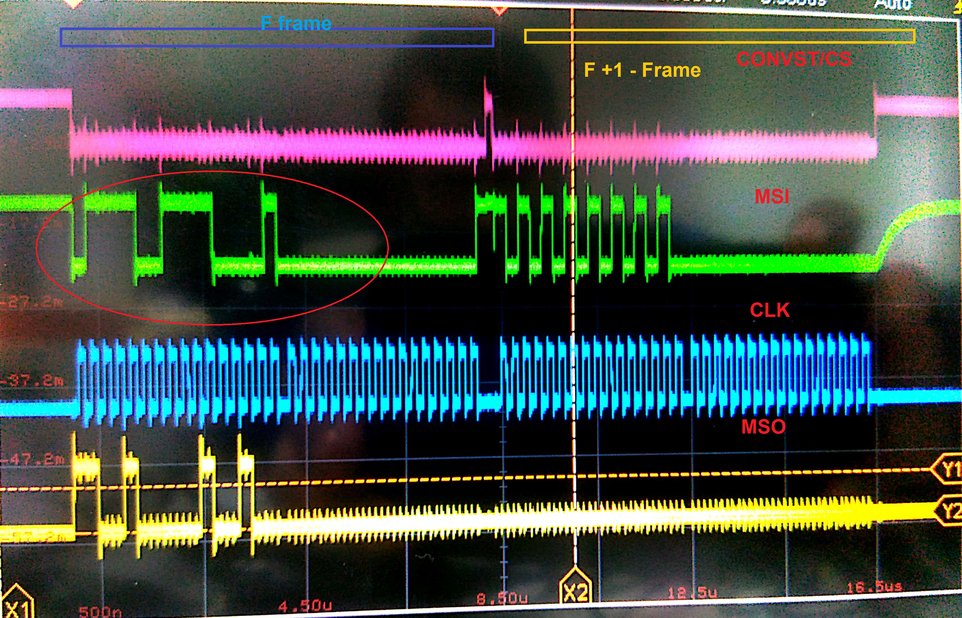

    Query
    1) I have marked red in circle , Is it unwanted , / OR it is coming due to while loop in the code?
    2) I am getting the data on Second frame by giving NO OP command. Is it Ok?

  • Hi Ramesh,
    Firstly, the signal name in your timing plot confused me. I think your "MSI" signal should be MISO which is the output (SDO) from ADC to your microcontroller. Also, your "MSO" should be MOSI which is the signal for sending the command from microcontroller to ADC (SDI). Please correct me if my understanding is wrong.
    1) I think it is the output data and related to your previous command.
    2) You have two questions in your two different posts:
    To answer your question " I am getting the data on Second frame by giving NO OP command. Is it Ok?", yes.
    The latest timing you showed is correct, you can see the register value of ALARM_H_TH_REG Register was shifted out to SDO line(MSI) by the ADC with first 16 clocks during frame (F+1), ithe value is 0xAAAA which is correct, the reason why you got the ALARM_H_TH_REG Register content not default 0xFFFF is you have changed the content of this register by writing "reg_write(0x24,0xAAAA)" command during your code Initialization. Hence, both your command and timing are correct, and the ADC is working well.
    For your second query about "I send ( CMD_WRITE_HWORD | DATAOUT_CTL_REG ) in F - frame , Then in the next frame (F+1) , i have got the date which vaying when i give external input to ADC pin.", this is correct that the conversion data will be shown in frame(F+1) for all other combination commands. For the reason about "your data is varying", I'm not sure if your signal source is stable or how much code variation you got. Actually, you can disconnect ADC's analog input and check the conversion code, I can help you check if you can send the code to me.
