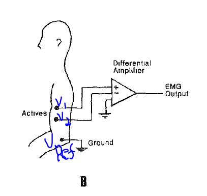

I recently ordered a ADS1298 DK for EMG application. I am confused on how to connect the 3 pin emg to the ADS pins?
I am connecting EMG's Mid and End muscle to the OpAmp's inputs (1 channel) and the 3rd reference pin to ADSS pin as an analog reference to the circuit.
Can you let me know if this configuration is Okay or I need to change the configuration. And also, if I add more channels, do I need to add any other reference pins?
Thank you for the help.

  • Hi Alexander,
    Thanks for the reply. I have attached the reference circuit here for EMG.
    As far as I understand from EMG, the reference of the EMG electrode is connected to the ground so that there is no external interference.
    So, going by the EMG basics, I was thinking of connecting the reference to AVSS and not ADSS (Sorry). Can you suggest any changes?
    Thanks and Regards,
    Sandeep.
  • Hi Sandeep,
    I see, thank you for the graphic.
    I would recommend setting the reference voltage at mid supply. So if you're using unipolar supplies (AVDD = 5V, AVSS = 0V/GND), that means setting the reference to 2.5V. For bipolar supplies (AVDD = 2.5V, AVSS = -2.5V), that means setting the reference to GND. This will ensure that the resulting signal is within the common-mode range of the PGA. Neither case will work with connecting this to AVSS, I recommend using the RLD function of the device to set the reference.
