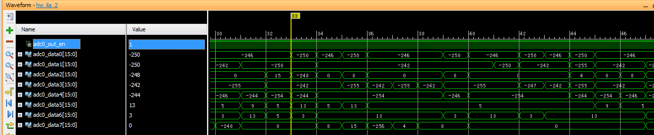

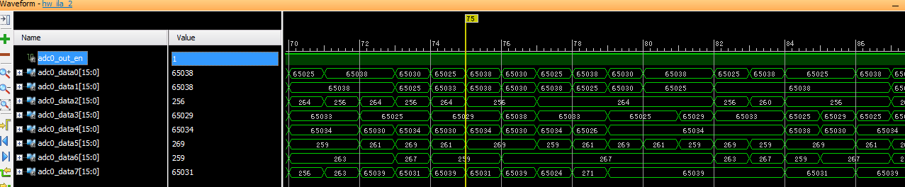

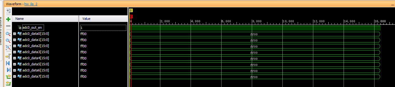

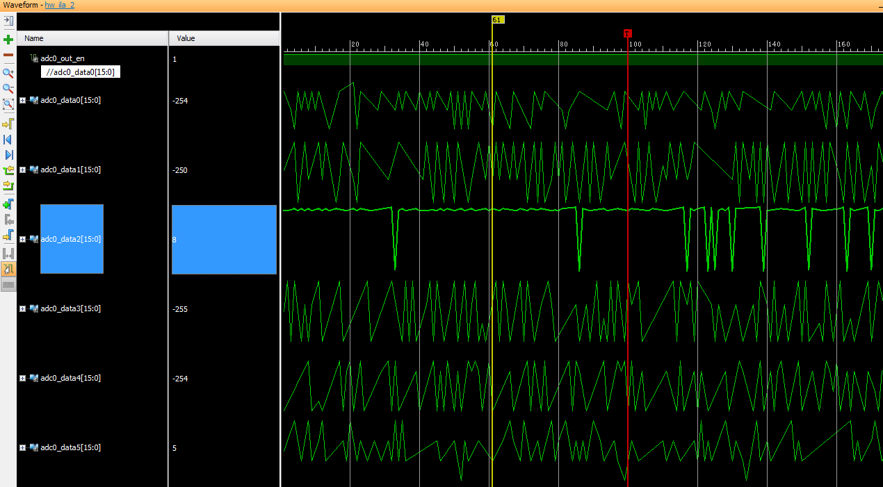

  • I use PC to upload some pictures and hope will help you analyse the problem :)
    My configuration,test pattern, ff00:
    My configuration, normal mode, digital signal:
    My configuration, normal mode, analog signal:
    Your first configuration:
    And the second configuration you provided is switch to MSB, and the signal is the same, so I don't show the pic.
    Thank you!
    Best Regards!
