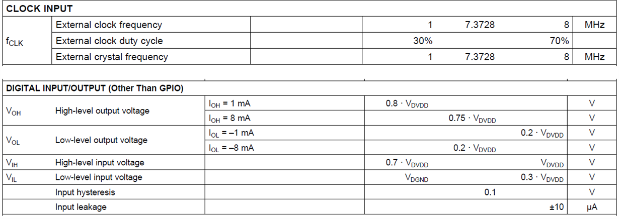

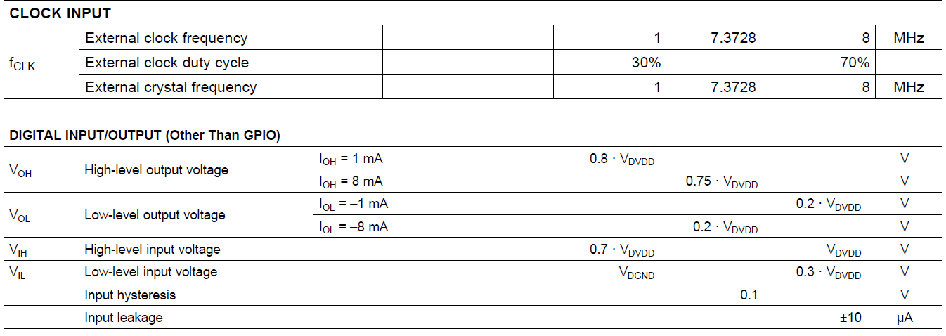

  • Hi Vincent,
    Here are requirements for an external clock signal:
    Notice that the clock signal amplitude should go below 0.3*V_DVDD and above 0.7*V_DVDD (with respect to DGND). Either square and sine waves should work.
