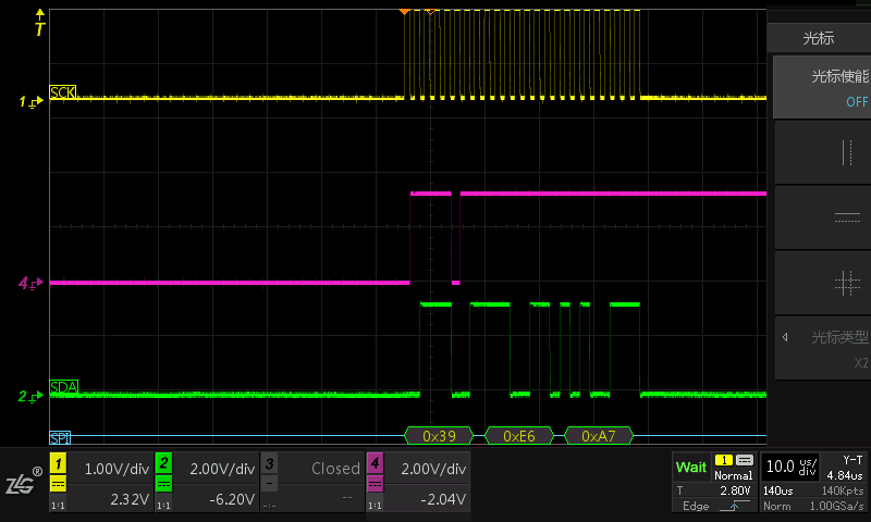

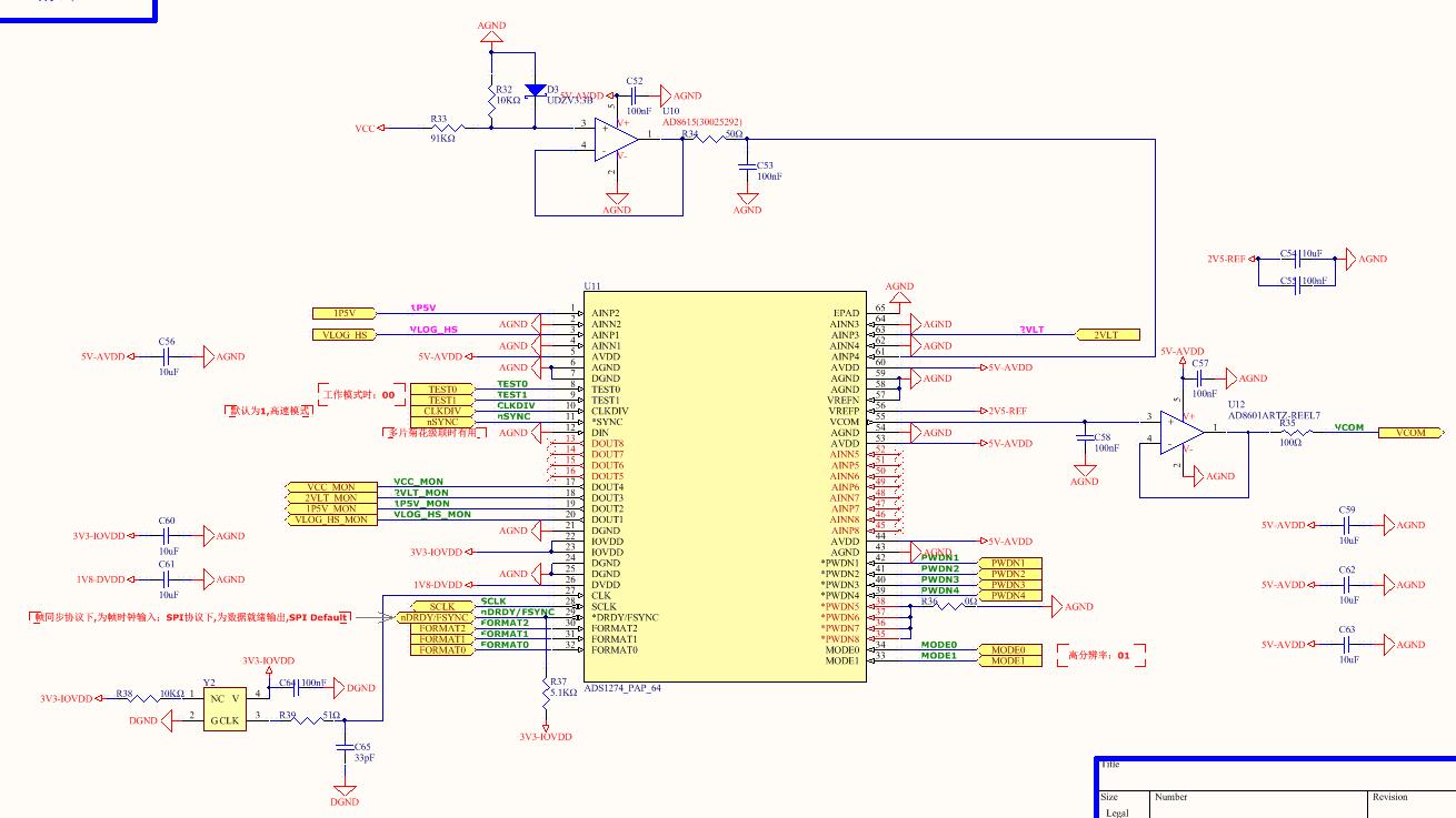

The sampling rate is 60k sps per input channel. I found the next sample data (data ready output/DRDY) comes earlier than I finish reading the current sample. Should I increase the SCK for this application?
Thanks.
