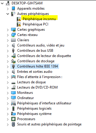

I recently purchased the Analog evaluation module ADS1299EEGFE-PDK and i cant manage to install it correctly. The documentation seems to be outdated in the User's guide "EEG Front-End Performance Demonstration Kit" because neither the names or the softwares are as they are showed, i'm a little lost. I am in Windows 10, to this day i have:
1) install ADS1299EEGFE-PDK-SW-installer, without the board connected to the computer
2) Connected the supply power +5VD/GND of J14  and the USB port to the computer
3) Nothing happens, not NI-VISA MMBO recognised, only unknown device (figure)
4) Install the other two sources: ADS1299EEGFESoftware-1.0.2-installer  and  ADS1299EEGFEFirmware-1.0.2-installer in that order. Is the order important ?
5) Launch the software and problem "Download failed.. Reset the hardware.." appeared
I have also tried installing as administrator and I have also disabled the Driver Enforcement. But as you can imagine, without success.
I can really use some help here! Thank You!
