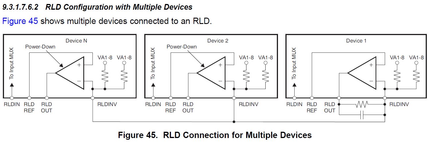

I'm looking at ADS1298 for an upcoming project. For this project, I want to daisy-chain two ADS1298 chips to reduce the signal count to control them. As described in section 9.4.2.2 (pages 57-58) of the datasheet, daisy-chaining requires that each chip be configured in the same way. It also says that the “RLD driver cannot be shared among the multiple devices.” Could you provide more detail on this statement?
Looking at Figure 45 on page 43, it shows the RLD (right-leg drive) connection for multiple devices. Device 1 is used to generate the RLD signal and the inputs from the other channels on the other devices are shared using RLDINV. The RLD op-amp on devices 2-N is powered down. If the devices are daisy-chained, would it be okay for the RLD op-amp on devices 2-N to be powered on? The RLDOUT, RLDREF, and RLDIN pins would not be used.
