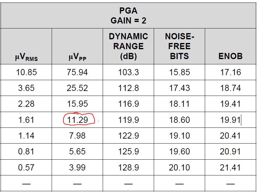

    If you are using one of the smaller two current source magnitudes, you might be more prone to noise interference when measuring relatively small impedances. At 2 kSPS and Gain = 2 V/V, each channel on the ADS1299 is expected to have about 11.29 uVpp of noise. 11.29 uVpp / 2 / ~600 ohms = 9.4 nA. Please confirm which current source magnitude you were using for these measurements and try increasing it as much as you're allowed to do so at that frequency.

    I am using the 6 uA and 24 uA current sources. I don't see how the 11.29 uVpp could cause a ~600 ohm shift on a 5 K ohm resistor measurement. It seems like it would be more like a 1 ohm shift ((120mV - 5.645 uV) / 24uA ~= 4999 K ohm). A 14.4 mV noise would cause something like that potentially.

    I agree - the 11.29 uVpp of noise would account for less than 1 ohm with 6 uA or 24 uA of lead-off current. ~600 ohms out of 5k is about 12% error.

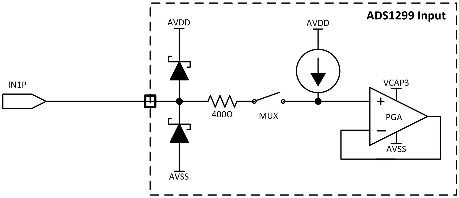

    I just got in touch with our analog designer for the ADS1299. He pulled up the design database and showed me that there is, in fact, an additional 400-ohm impedance in series with each input pin. You can expect a few 10s of ohms worth of additional routing, but this varies from channel to channel.
    The 5k-10pF EMI filter on the ADS1298 was removed for this device since the impedance introduced too much noise to meet the performance targets. I'm not completely sure why the 400 ohms was kept there, possibly for protection of the internal switches. Anyway, my apologies for misleading your earlier.
    Here's a diagram of what the input structure looks like:
