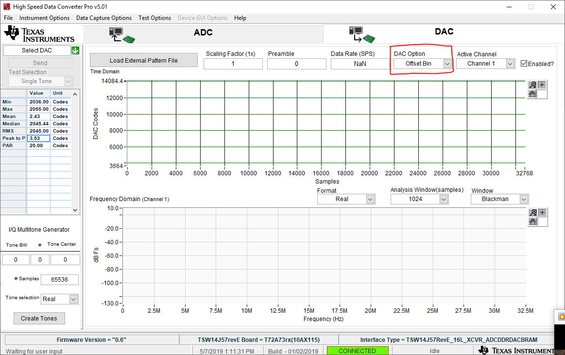

    1. In HSDC Pro, I edited sawtooth wave for Importing as 'Load External Pattern Files' by text files. (the lowest value is 0, the highest value is 16000)
    and I loaded my text files and then the wave's frequency was okay, but amplitude was reduced 1/4 peek value in DAC time domain window.
    Can you tell me about the relation of text file's peek value and Imported external file's peek value?
    2. and it's actual output looks like operating 2's and offset bin reversed. please give me an example or explain of principle of 2's and offset bin.

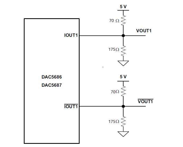

    3. I have purpose that tsw1400 and dac5675a use as voltage output without transformer. so i refer to 'Passive Terminations for Current Output DACs's 3.1 Single-ended output, No transformer Required'.
    there is figure 6 including the voltage source as 5V. Should I use 5V unrelated to AVDD 3.3V in DAC5675A?
    4. and i want to know about processing(some of equation) of adjusting resistor combination in same page. in above datasheet said, Excel spreadsheet is available but i can't find in ti.com.
    can you tell me where the spreadsheet is?

    1. HSDCpro software takes 16 bit data and data is MSB justified, the data you are importing HSDCpro is 14 bit. To make your data MSB justified you will have to shift you data left by 2 which same as multiplying the data  by 4.
    2. Please select offset binary option in HSDCpro it should fix your issue.
    3. Use figure 24a from the datasheet.
    4. Here is termination you will need for DAC5675A without the transformer.
