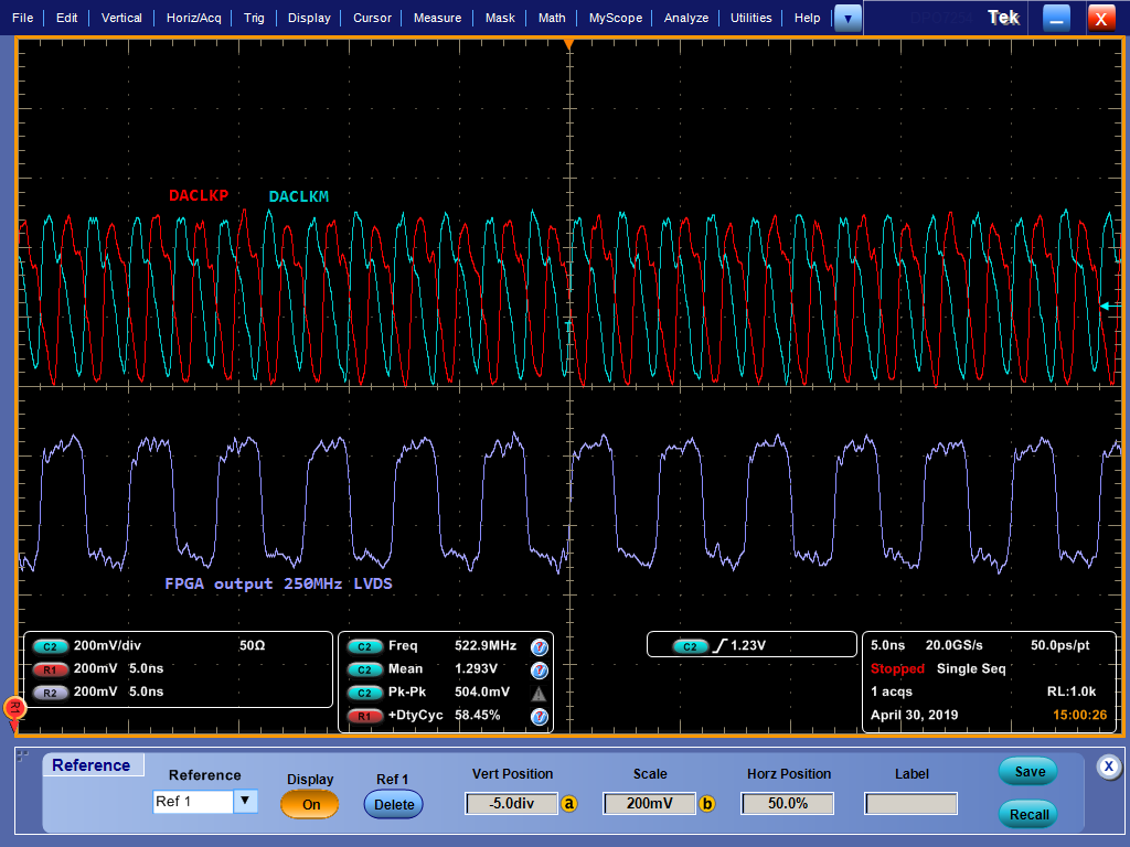

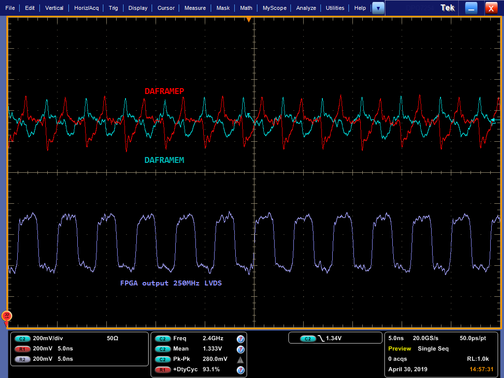

We have encountered problems with signal integrity on ADS42LB49 and its QDR LVDS interface. The ADC is connected to FPGA (Ultrascale+) with internal 100ohm terminations on LVDS input buffers, the clock we used for the ADC is 500MHz differential sinewave with 1Vdiff-pp level (about 500mVpp on each clock pin) and we are using internal clock divider by 2.
We measured the ADC output signals by single oscilloscope probe (TAP2500). Currently we can measure only one signal of the differential pair at a time as we only have one probe. Therefore phase alignment of positive and negative signals is not accurate as they are measured separately.
Take a look at the attached images. There are two measurements – ADC frame output measured directly at ADC pins, and DACLK measured approx. 3 cm (1.1 inch) away from ADC. On both pictures there is also measured LVDS signal generated by FPGA (violet trace), to check if the probing is adequate - we would expect something like that.

3) We have tried to set the double strength of the LVDS buffers by setting the LVDS DATA STRENGTH register bit. This resulted into higher voltage swing but not changed the signal shape.
4) We have tried to change clock division to factor of 4, but we have not observed improvement in the signal shape (frequency did go half).
5) We have changed the interface to DDR LVDS to lower the interface frequency, but without improvement.

7) We cut PCB traces of one pair and soldered on 0402 100ohm termination resistor and measured at that resistor. Signal changed a little bit towards better shape, but its still pretty bad.
Questions:
1) We noticed the output common mode voltage is 1.25V. The datasheet specifies OCM voltage as 1.05V. Could this signify any specific problem?

  • Dear Jim,
    regarding 500-MHz input clock, the datasheet clearly states on page 35, Chapter 8.3.2 Input Clock Divider:
    "The divide-by-2 option supports a maximum 500-MHz input clock and the divide-by-4 option supports a maximum 1-GHz input clock frequency."
    Therefore we have designed our entire system around 500 MHz clock and we cannot change that without complete redesign.
    Does it mean there is an error in the datasheet then?
    Jan
  • Jan,
    Sorry about that. I confused this part with another. You are correct, you can operate at 500MHz with a divide by 2 setting. I did load your config file and changed the output to DDR mode and was able to capture valid data with a 500MHz 0dBm input clock. Have you tried slowing down the sample rate to see if maybe you are having a setup or hold time issue with the FPGA? If you would like, we can take a look at your schematic for you.
