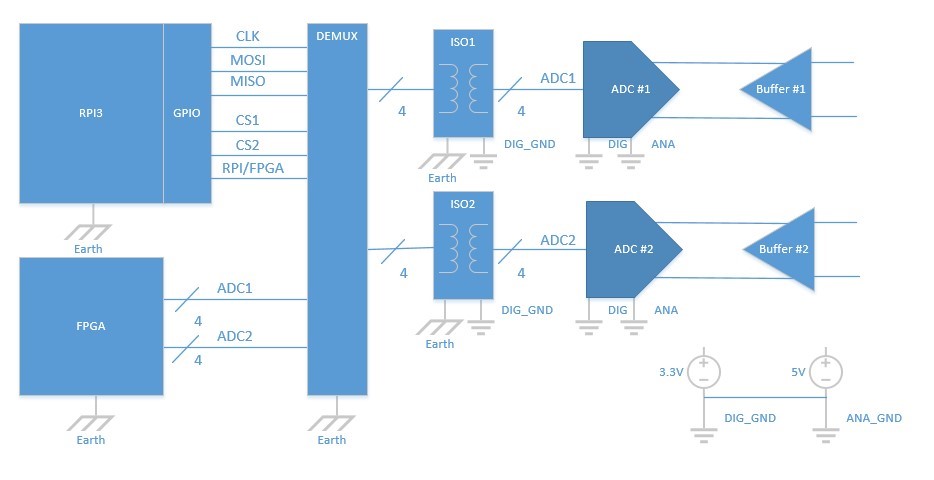

  • Thank you, Chris,
    I have the RPI3 isolated from the ADC side. See the diagram below:
    Both ADCs have the same behavior. The AINx works, but the TDAC, and the PS monitor don't.
    PS: the RPI is debugging only. The FPGA is not ready/implemented.
  • The problem is solved!
    The external reference was causing the problem. I was using an LTZ1000 with differential output. Somehow this configuration was backing feed to ADS1263 internals.
