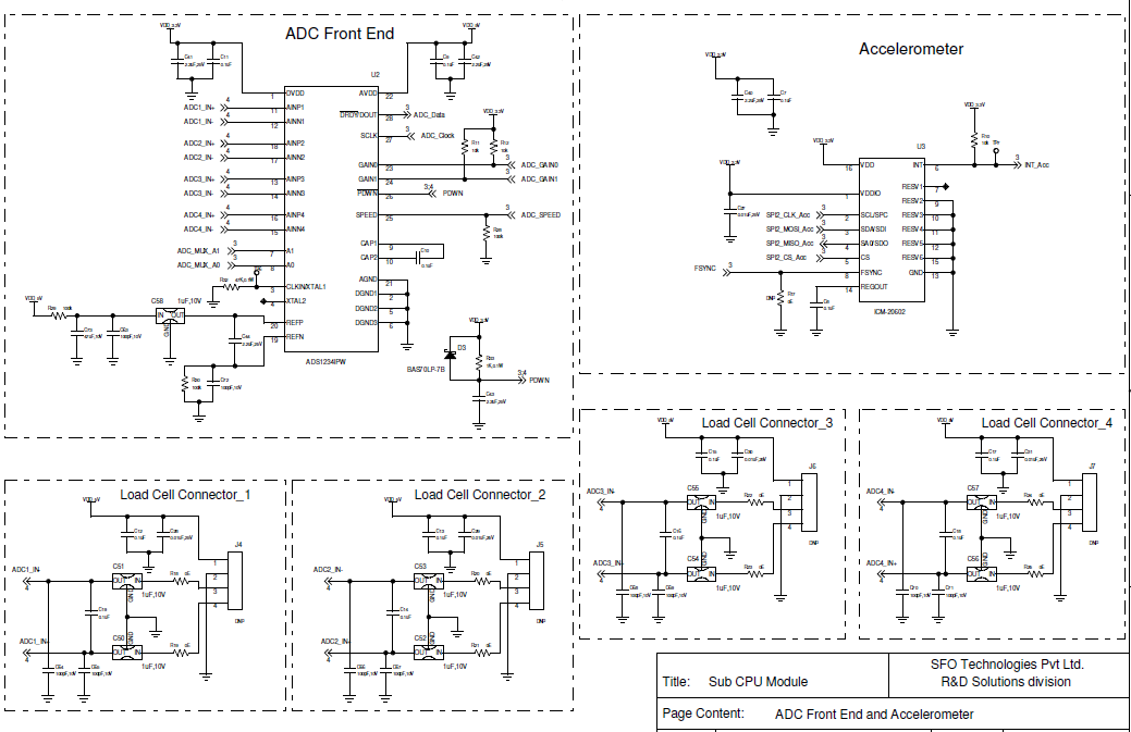

  • Hi Bob
    Please review the schematics of ADC section.Diode and cap on PWDN pin is not installed.The fixed offset issue is resolved after giving a 3 sec delay in the code initialization as we suspected the issue is with power stability.But now there is a small drift in the reading and keep on increasing with time.Is there any such issue seen earlier with this ADC.

    As far as seeing drift, this can happen as the supplies settle (which also includes the reference) and temperature drift from the ADS1234 self-heating. The most obvious drift related to self-heating will relate to the offset drift. Again issuing 26 SCLKs or more will re-calibrate the offset of the ADC. This can be done at anytime, and as often as necessary to cancel the offset drift effect.
    Another drift effect is possible from the analog inputs as it relates to analog settling. I can't read from the schematic what the input filter resistor values are but you have 1uF EMI filter caps followed by a differential cap of 100nF. I think the bigger concern is the reference input filter. It appears that the input filter resistors are 100k followed by the 1uF EMI caps and a 2.2uF differential cap. 100k input resistors are way to large of a value and the reference settling can take 10 seconds to fully settle. The concept is to make a ratiometric measurement whereby the excitation voltage is the same as the reference voltage. Any drift in the excitation will cancel out of the measurement. However if the filtering is much different between the analog input and the reference, any change or drift of the excitation source will appear differently in time. If the reference is more heavily filtered than the analog inputs it will take time for the reference to settle with respect to any change or variation in voltage. So try to match the analog input filters and the reference filter to be similar.

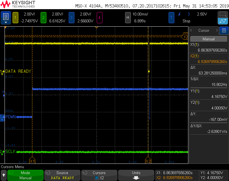

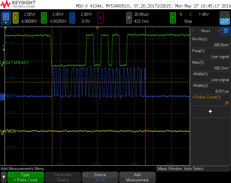

  • Dear Bob,
    1. As per your request , Waveform of PWDN pulse, Offset calibration and data reading has been attached for your reference to detail the start up process.
    2. Yes , the offset are seen on all the four channels and offset values are almost same on each channel. in Our design both excitation voltage of load cell and ADC reference voltage are 5V. The load cell is having a sensitivity of 1 mV/V ( here the capacity is 50 kg, so max. output from load cell for a fully loaded condition would be 5mV and we are running the ADC with a gain of 128, thus max analog input range of ADC would be +-17 mV something. The typical values of offset we got are 194 kg. 120 kg, 38 kg on each load cell and these values are not provided by the load cell that we confirmed by measuring the voltages across load cell output wires..) Datasheet of load cell is attached.
    3. yes we have measured voltages on AINP and AINN with respect to GND and its value is 2.5V and is not violation to common mode voltage range of ADS1234.
    4.yes we have measured and expected voltage of 5V obtained.
    5. We can't share actual test setup as it highly confidential. But I can assure test setup is not affecting data capture as we are getting correct reading when a weight is placed on the load cell.
    6. there is No wiring or connector damages.
    Regarding the data calculation you have mentioned above, our Firmware team have confirmed that the calculation method is same as that of your suggestion and we could correctly convert the output from ADC chip to weight for both positive and negative inputs.
    DataReady Vs PDWN pulse
    Offset calibration with 26 clock pulses
    Data reading, Error data is obtained
    Load cell datasheet( 50kg)

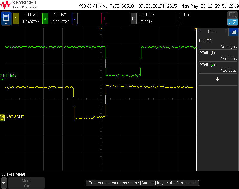

  • Hi Rino,
    Welcome to the E2E forum! The second scope shot is not clear. There may be some number of issues with probe grounding or connections, but PWDN is showing low, and the SCLK is very noisy. The minimum low/high time for the SCLK is 100ns. This appears to be in violation even though the SCLK frequency is quite slow. Can you explain the differences as to why some of the plots are very clear, while the one I'm referring to is poor? Are all the plots being probed at the same place? Has the timing been verified to make sure the offset calibration has actually taken place?

  • Dear Bob,
    please refer the attached scope shot of offset calibration clocks. I think all the timing constraints of clock pulses are met.
  • Hi Rino,
    This scope shots is much improved over the one shown previously.  As we have not clearly identified what is actually happening at the ADC, I want to make sure I fully understand the current situation.

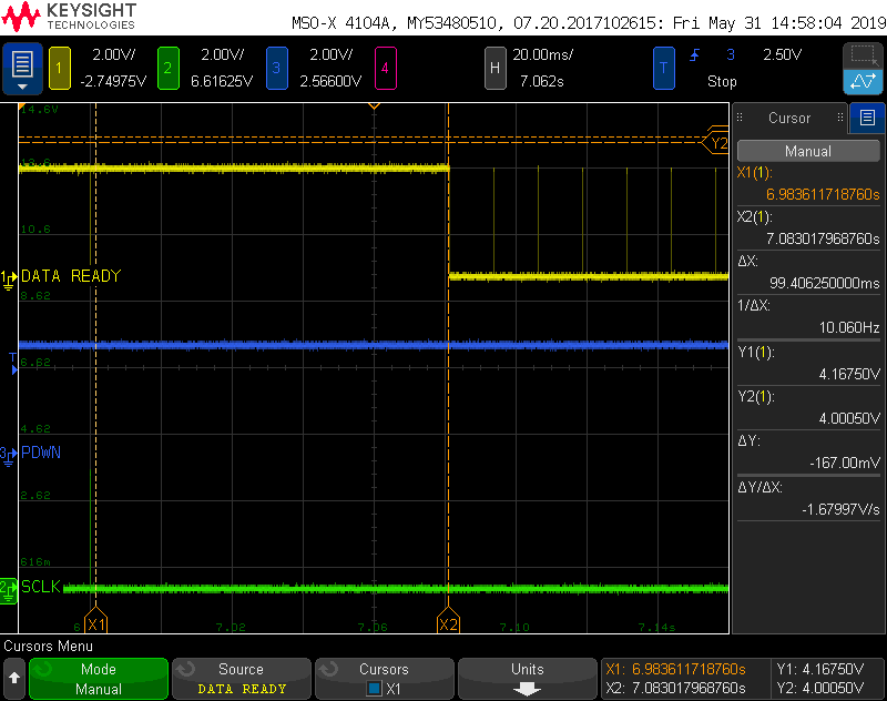

    After PDWN goes high it should take about 402ms before DRDY/DOUT transitions from high to low.  This will signal that the device is operational.  At this point toggle the PDWN pin to reset the ADS1234.  After PDWN goes back high, DRDY/DOUT will be high for about 402ms then goes low.  You can capture this data read on the scope while issuing the additional clocks for the offset calibration (26 SCLKs total).  This scope shot would be good for me to see.  The calibration will take about 803ms from the last falling edge of SCLK and is signaled complete when DRDY/DOUT transitions from high to low.  Again, capture this data on the scope and please send both of these shots to me so I can see if the calibration is truly taking place.  You should also see the timing as described above to also help verify.

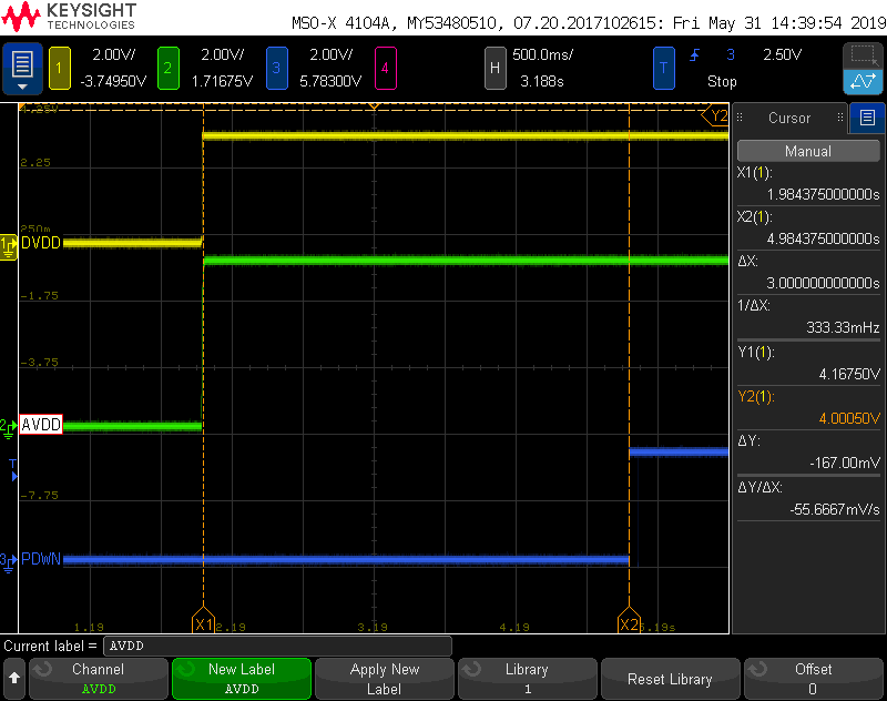

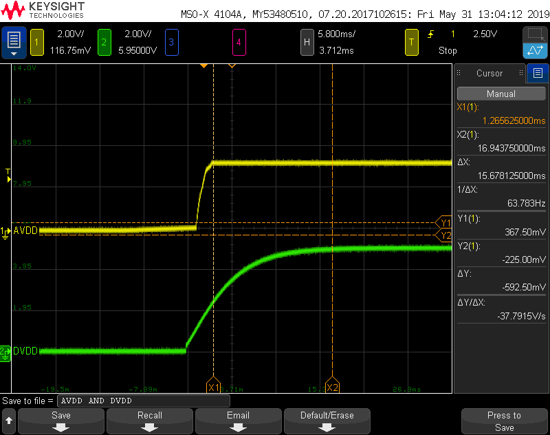

  • Dear Bob,
    Please see below attached Images showing the timing requirements suggested in your previous reply.
    Please note that we have been Configured the ADC in High speed mode , that is 80 SPS , so that the time delays would be different and is given in ADS1234 datasheet.
    One more point is, after providing an initial delay of 3 seconds for PDWN to go high after settling both DVDD and AVDD, the offset issue is resolved without any offset calibration pulses. We need clarification whether Offset calibration is required or not. because without giving the above 3 seconds delay, there has been high offset value even with offset calibration.
    DVDD Vs AVDD settling delay
    3 Second delay for PDWN after AVDD is settled
    DATARDY High to Low transition after PDWN goes to High(1st Transition)(63 ms delay)
    DATAREADY LOW PULSE (840 us)
    PDWN Low Pulse ( 180 us)
    DATAREADY High to Low transition after PDWN pulse( 54 ms delay)
    DATARDY High to Low transition after Offset calibration last pulse( measured delay is around 100 ms as given in datasheet)

  • Hi Rino,
    Thanks, this is excellent information! You are correct with the timing. I was assuming 10sps, and if you are using 80sps then you would adjust the timing as shown in the ADS1234 datasheet. From the scope shots I see normal activity and the proper timing which shows the device is powering up properly. The offset calibration is important at startup to remove any device offset from the PGA and modulator stages. If you can accept the +/- 1ppm of FS offset error in your measurement, then you would not need to issue the offset calibration. However, I would still highly recommend it.
    As to waiting 3 seconds, this seems to be very unreasonable but may be required based on analog settling. I have yet to hear definitively how you are powering the reference inputs. Based on the schematic I reviewed earlier I saw there was 100k resistors and 2.2uF differential cap. The RC time constant (200k*2,2u) is 0.44s. 5 time constants would be about 2.2 seconds. As the reference would need about 17 time constants to settle to a good value you would need about 7.48 seconds total for the reference to settle. So from this calculation I can see that it would take about 3 seconds for the reference to settle to about 98%. If there is 100k series resistance for your filter inputs, then I would strongly suggest lowering these values. Also, there will be a small bias current drawn from the reference which will place a voltage drop across the input resistor creating an error. I would suggest that the reference filter resistor value be in the range of 1 to 5k.
    With the proper startup sequence, the ADS1234 should operate as expected. PDWN should only go high after DVDD has reached nominal operating voltage (16ms). Issuing the offset calibration is not required, but highly recommended. Limiting the settling time of the reference is also highly recommended.

  • Dear Bob,
    Thank you very much for your quick reply.
    Regarding reference input voltage settling time your calculations were correct. But the thing is that, our entire system takes about 10s to complete boot up then only it displays wieght values, so that the reference input time will not affect the correctness of the reading, even if it affects how can this affect in such a way that the ADS1234 is giving a very high value on all the channel's as given in the previous replies( like consistinctly giving weghts lik3 153kr 34kg on each channel and giving a proper output variation when a weight does).
    As per your suggestion we have changed the series resistor from 100k to 100ohm but this change is done only after providing 3s delay.
    anyway by providing those 3 s delay , our system working fine now without any offset calibration. You can share any points that i missed to ifentify the rooy cause of ADS1234s behaviour.
