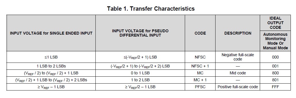

    1. Yes you can connect both AVDD and DVDD together to 1.8V, not that this will limit the Analog Full Scale for the input to 1.8V. Is this acceptable?
    2.  Information about the conversion results can be found in the ADC Transfer Function section of the Datasheet, starting on Page 21. The conversion result will be available on the SDA line.
