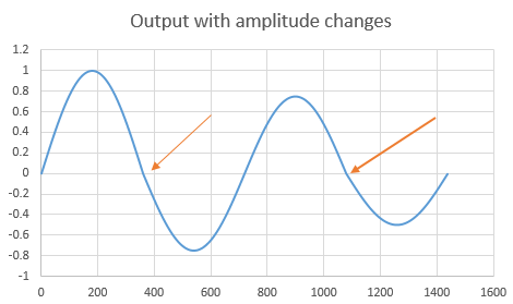

Customers want to use TPL0102 for audio volume adjustment.
TPL 0102 causes Wiper Glitch. Can this Glitch become a zipper noise?

    The phenomenon that are hearing is due to non-zero crossover volume change.  It can best be illustrated with a diagram.  Consider a sinewave (the music you are playing), but when you change the PDOT you are really just changing the amplitude of the sinewave.  If you have a sinewave of 1Vpeak, then reduce its amplitude to 0.75V, then to 0.5V at any random, you will see something like the following output.
    These sudden transients can be audible, and factors like glitch or switching delay might make them even more prominent.
    In our early audio DACs, TI had similar issues when adjusting volume.  For this reason, our audio DACs are designed to switch the code only when the output is at nearly 0V (or at the center point).   This means that the amplitude changes when the output is already minimal.  Seem the image now where I moved the volume changes to the nearest 0V crossing:
    Now the changes take effect with minimal transients.
    Now in regards to your circuit, I would recommend that you use the MCU in the system to coordinate the DPOT updates to implement a similar zero-crossing updates scheme.
