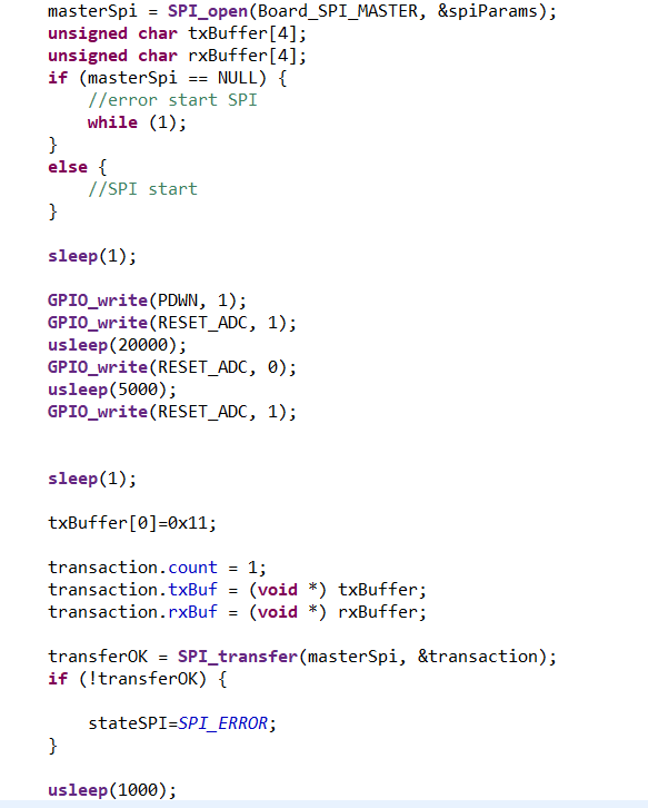

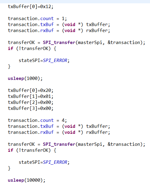

hi,

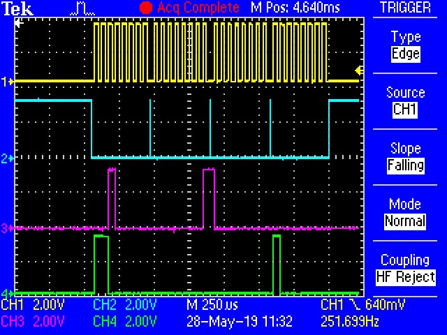

I have a problem with the SPI communication.
I can't describe the registers to configure the ADS1298 for my application. Therefore I tried to read only the ID at the beginning. But this gives me the wrong value back.
yellow : SCLK
green : MISO
blue :  CS
red : MOSI
my code:
