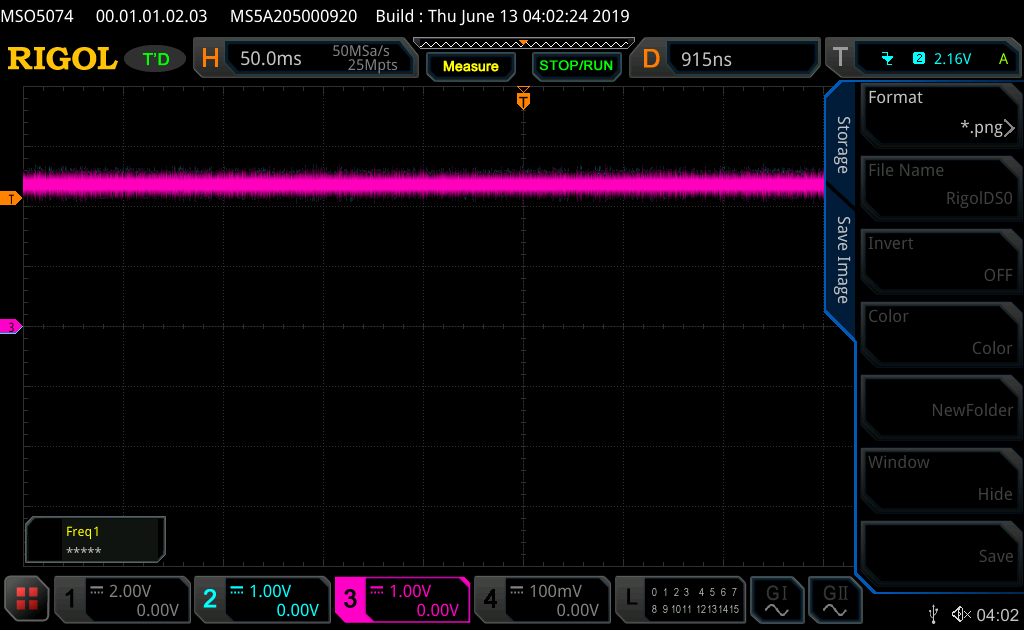

I'm attempting to use the DAC1282 DC output to troubleshoot the ADC1282 and how I'm parsing the data the ADC1282 is outputting.  I have been able to adjust the sine frequency and gain without issue, and I have been able to read the registers from the DAC1282.  However, when I attempt to put it into DC mode by adjusting the Mode bits and the DCG0->DCG2 registers I just get a static output from the DAC, both outputs are sitting at 2.386V (not differentially) no mater what I try to put the DC gain at.  I am using a single ended power analog power supply of 5V and VRef of 5V from the REF5050 chip and a seperate regulator for the supply voltage.  I've tried triggering the sync pin and changing the order that I change the registers and nothing appears to get the DC output to operate correctly.  Any insight would we greatly appreciated.

  • Hey Chris,
    I have tried reading them back to make sure the registers are actually configuring. I also made sure to read them before and after to ensure that my reading function is working properly.  I am setting registers 0 through 6 as follows: 0x01, 0x00, 0x00, 0x00, 0x3F, 0xFF, and 0xFF.  I'm having the same issue when I try to use the pulse mode, I can see that the device registering a mode change but both outputs have a common static DC output that doesn't change regardless of the register values.  I'll try and attach what I'm seeing on my scope, its hard to see because both-outputs are quite noisy (which I understand is to be expected) and they overlap, almost entirely.  Let me know if you can find anything.

  • I believe I found the issue.  I had the byte endianess flipped, instead of 0xFF, 0xFF, 0x3F, I was writing 0x3F, 0xFF, 0xFF which was just outputting a very small DC output.
