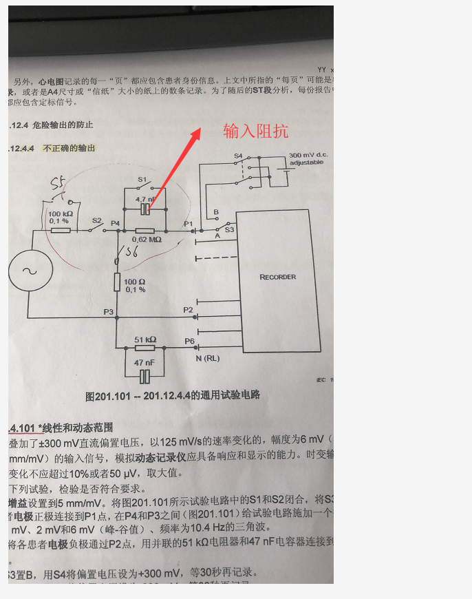

our customer used ADS1291 pass the FDA certification,
there are some questions:
S1 closed it's ok, S1 open the ECG signal frequency*10,
if you have some suggestion?

Hi Kane,
Thanks for your post.
This test is designed to validate the Recorder system input impedance. I believe the passing requirement is less than 5% signal loss when S1 is open. The results you are seeing ("ECG signal frequency*10") is likely just noise, but it's difficult to say for sure without seeing a scope capture of the ADC input or output data.
Hi Kane,
I can send you an email offline if you need to share proprietary information, but for now I think we can continue this conversation on the forum. The problem described in the initial post is not adequate to provide much more suggestions.
