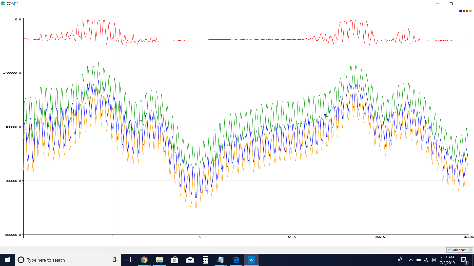

    The following is a sampling of data using all the information we've talked about.
    I believe that the red data is correct EMG data.  However, I cannot figure out why the other 3 channels shown seem to not follow the same pattern.  The channels shown are channels 1-4.
    My registers read the following in hexidecimal...
    CONFIG 1 85
    CONFIG 2 10
    CONFIG 3 E4
    Channel 1 00
    Channel 2 00
    Channel 3 00
    Channel 4 00
    Channel 5 06
    Channel 6 00
    Channel 7 00
    Channel 8 07
    RLD_SENSP 07
    RLD_SENSN 07
    I'm trying to generate an RLD signal based off an average of the first three channels.  I think I have CONFIG 3 correct.
    Any thoughts on the rest of the signals?
    Spencer
  • Hi Spencer,
    Where exactly are the electrodes connected on the body?
    If you change their position, Ie swap channel 1 and 4 do you see the same signal pattern?
    I would like to know if this is a channel configuration or an electrode location issue.
    How does it look if you change CONFIG3 to EC to generate the RLD signal internally?

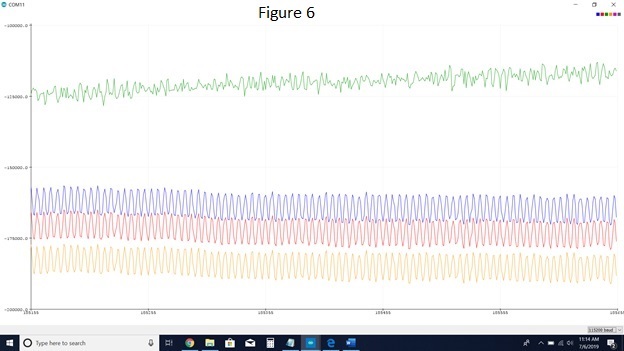

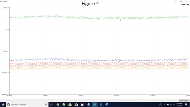

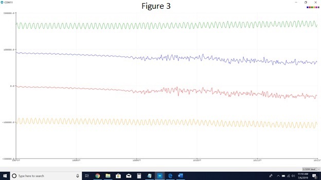

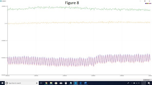

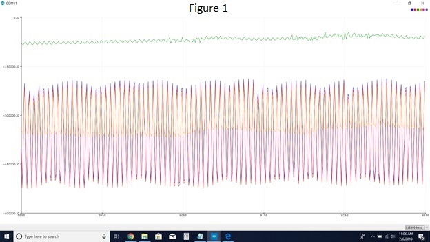

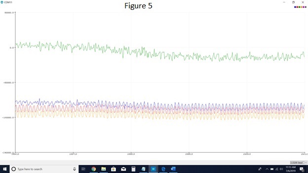

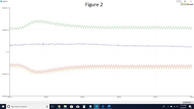

    I use a sleeve of 34 electrodes which are spaced most places on the forearm. I can essentially use any for a set of differential pairs. My current setup involves using one electrode near the elbow/ulna as my RLDOUT signal (Currently channel 8 N). Another electrode near the elbow/ulna is the Negative IN for channels 1-7. The other electrodes are placed sporadically around the forearm in no particular order (and I can move them to more or less any location around the forearm).
    The following series of figures shows data I collected in one sitting. Figure 1 shows the noise when connected to an AC power source. I then disconnected my laptop from the wall for the remaining figures.
    Figure 2 shows that when using CONFIG 3 = 0xE4.
    Figure 3 shows that at some points, I can get two channels working.
    Figure 4 shows that without any further commands to anything, the two channels can change.
    Figure 5 shows that when a channel drifts into another channel (or area), it changes from good EMG data to noise.
    Figure 6 shows that one of the two channels has been lost to noise.
    Figure 7 shows that all the channels have been lost to noise (because of the drift mentioned in figure 5).
    Figure 8 shows a different two channels with good EMG data.
    I feel as if I have tried several different channel settings for both the configs and the channels themselves.
    If you have any suggestions, I would happily take them. In the meantime, while I wait for your response, I will more heavily document any patterns I can find.
    1. Is there a good way to reduce drift?
    Thank you for your extended help in understanding RLD with the ADS1298.
    Spencer
    Figure 1
  • Hi Spencer,
    Very interesting application. No rush, but when you get the chance if you could re-post the pictures that would be great.
    What kind of drift are you referring to? Is the DC level of the signal slowly changing over time?
    Try placing the RLD electrode in a more central location and see if that helps.
  • That's odd the pictures only semi-uploaded.  I'll give it another shot.
    The drift I'm referring to I believe is DC offset, but it can move significantly over the course of 5 minutes as you'll see from the figures.
    I'll move the RLD and see if it changes anything.
    Spencer
  • Hi Spencer,
    It happens.
    Alternatively, you may want to try blue-wiring a mid supply common-mode configuration like what is depicted in this post:
