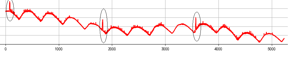

Why does the PPG waveform output from AFE4404 have abnormal bulge waveform?
Other Parts Discussed in Thread: AFE4404, AFE4404EVM
As shown below, the PPG waveform output from AFE4404 has abnormal protruding waveform. How to solve this problem?
The configuration is 500HZ sampling rate and the register settings are as follows:
led2_start_end( 0, 399 );
led2_sample_start_end( 80, 399 );
adc_reset0_start_end( 401, 407 );
led2_convert_start_end( 408, 1467 );
led3_start_stop( 400, 799 );
led3_sample_start_end( 480, 799 );
adc_reset1_start_end( 1469, 1475 );
led3_convert_start_end( 1476, 2535 );
led1_start_end( 800, 1199 );
led1_sample_start_end( 880, 1199 );
adc_reset2_start_end( 2537, 2543 );
led1_convert_start_end( 2544, 3603 );
amb1_sample_start_end( 1279, 1598 );
adc_reset3_start_end( 3605, 3611 );
amb1_convert_start_end( 3612, 4671 );
pdn_cycle_start_end( 5471, 7839 );
prpct_count( 7999 );
timer_and_average_num( true, 1 );
seperate_tia_gain( true, 0, 4 );
tia_gain( false, 0, 3 );
led_currents( 15,3,3 ); //LED1\2\3
dynamic_settings( dyn_modes );
clkout_div( false, 2 );
int_clk_div( 1 );
