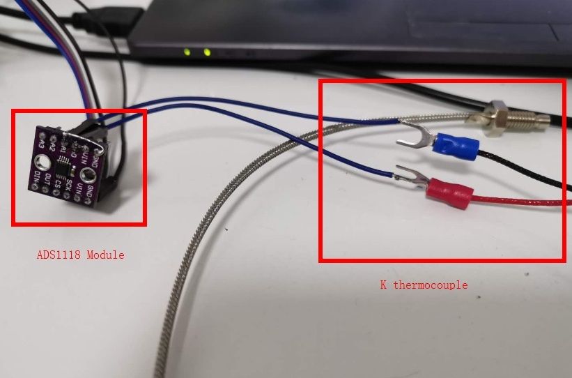

  I use the stm32 microcontroller to drive the ADS1118 to collect K thermocouples.The collected data is incorrect.  Here's how I'm doing it,  See if there's a problem.Thanks

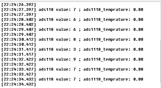

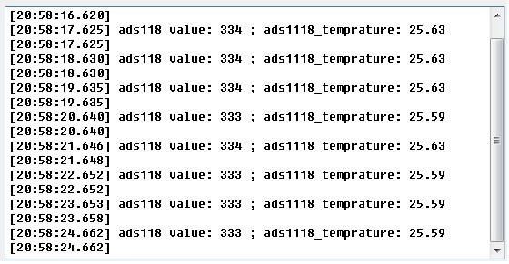

       In temprature sensor mode,the data is normal.  In ADC mode,the data is incorrect.  See  the screenshot below.
      1、This is ADC mode
        2、This is temprature mode
  • Dany,
    Right now, it looks like the internal temperature sensor measurement is working fine. If you're getting about 25.6°C, and the device is at room temperature, the reading should be fine. However, the ADC value is reading 0 or 1 for the measurement.
    This could be one of several things. First, you could be shorting the input voltage somewhere in the schematic. If you are running at the highest data rate, you might be seeing a little noise, with some offset. Second, you could be setting the wrong full-scale range for the ADC. Normally you would want to set the voltage to ±0.256V. For example, if you are in the ±4.096V FSR, the LSB for that range is 125uV. That is still small, but it would be easier to see deviations if you were in the ±0.256V FSR where the LSB is about 7.8uV.
    For the settings, I would also check a couple extra things. I would definitely use the device in single-shot conversion mode. When changing channels, Use this mode to make sure that I get the right reading for the right channel. I would also use a slower data rate to make sure the noise is not a big factor. You can look at the ADC settings for the thermocouple cookbook that I mentioned in my last post.
    After that, I think you should measure a real voltage source instead of a thermocouple just to test your system.
    If none of that helps to debug your system, then post your schematic. I'd like to see all of the connections to the ADS1118 and see what else is connected to the input.
    Joseph Wu

       Just now, I'll configure the full scale rang as your suggest. The data measured are as follows:
    #define ReadADC_Reg                0x8B8B
    Hardware connections :

    It seems to me that you're getting the correct data, but not reporting the temperture correctly. For calculating the temperature, you must first convert the cold-junction temperature to voltage with the following diagram.
    For the ADC, you get values for the thermocouple measurement of about 7. You do have some noise, which might be from EMI pickup from the wires in the system. If you do get 7 as an output code, and are using the ±0.256V FSR this converts to:
    7*7.8125uV = 54.68uV
    Then you use the internal temperature sensor and get the temperature. In your previous readings, you got 25.59°C (as an example).
    You then convert that temperature to a thermoelectric voltage through a k-type thermocouple table. This converts to 1.02415mV. Add this to the thermocouple voltage of 54.68uV. This becomes:
    1024.15uV+54.68uV = 1078.83uV.
    Convert this back to temperature and you get: 26.938°C.
    Joseph Wu
