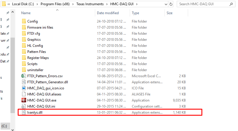

    • Any DLL files missing from the installed location. Antivirus might sometimes remove the dlls. Please make sure the installed location looks similar to below.

    Thanks for the troubleshooting steps! Unfortunately these do not seem to be the issue in my case:
    1. I verified all the files shown in your screenshot are present on my system
    2. I verified .NET Framework 3.5 is enabled in the control panel
