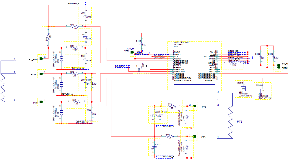

We use ADS1248 in the temperature measurement circuit of the PT100 sensors.
The measurement scheme is made with requirements of the datasheet and application mode recommendations.
In general, the circuit works correctly, but when the PT100 sensors are connected or disconnected from the circuit with the power supply turned on, the ADS1248 chip fails.
How to prevent this situation?

    Is the IDAC current running through the PT100 sensor when the sensor is removed?
    Can you provide a schematic?
    What do you mean by the ADS1248 fails? Is the data corrupted? Is the chip locked up?
    Are there any diodes on the inputs to prevent transients from reaching the device?
    When the sensor is removed, the IDAC current is not running.
    The ads1248 fails - the data is corrupted, and when i try to write to internal registers i dont get back the same data when i read.
    And the schematic is attached , please advice.

  • Hi Efim,
    Plugging and unplugging sensors in is typically not a problem if there's adequate input protection. Since the excitation current is being sourced through the analog inputs, this is probably where the issue is coming from.
    The TVS diodes will pass 12V, and probably fully clamp around 16-17V. The 20ohm input resistance is too small to prevent the large current from entering the analog inputs. 12V - 5.3V drop accross the diode is 6.7V. Divided by the input resistance of 20ohm yields 335mA of current flowing into the analog inputs. The absolute maximum rating for the device is 10mA.
    At this point, the device may be damaged. Instead of sourcing the current through the inputs, try using the unused pins to source the current, bypassing the input filters. Schottky diodes can be added to the excitation current lines to prevent large voltages from reaching the ADC. Additionally, larger resistors can be used for the analog input filter.

  • Hi Efim,
    I understand the reason for disconnecting and re-connecting PT100 sensors now.
    I believe you have 2 options, modify your input protection scheme such that the input current is limited to less than +/-10mA, or try evaluating the ADS124S08 which has additional input channels.
    This video series is still in the works, but has lots of information to get started on input protection: https://training.ti.com/eos-and-esd-adc?cu=1128375
    I'm hoping to complete the series by end of next week. The series focuses on SAR adc's, but most of the content is applicable to delta-sigmas as well. In short, you will have to increase the size of the filter resistor to limit the current as I pointed out in my previous post. 335mA is too much current for the device to handle.
