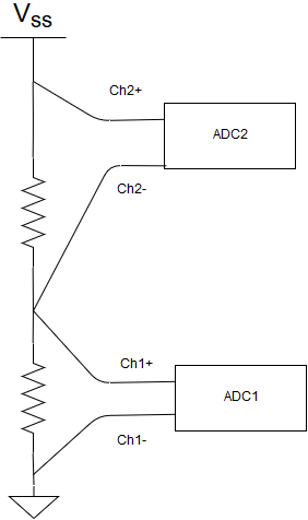

    I noticed that each channel has an associated AGND, are these all internally connected. Ideally i'd like to measure the voltage deferentially across a range of sources connected in series, something along these lines, where ADC1 and ADC2 in this picture refers two channels of one ADS8568 package with the + and - denoting the bipolar inputs of each channel:
    thanks in advance for any help!

    Unfortunately, the AGND references are all common, so you'd have to reference the inputs to a common point.  Also, the inputs of the ADS8568 are typically driven by an external amplifier, so you could get creative that way.  What sort of voltage(s) will the VSS input be exposed to?

    It would be a scaled down max voltage of 1KV.
    Are there any recommended drive circuitry? I'll be using external amplifiers with capacitive load compensation. Not sure if there's any other drive compensation I need to apply.
