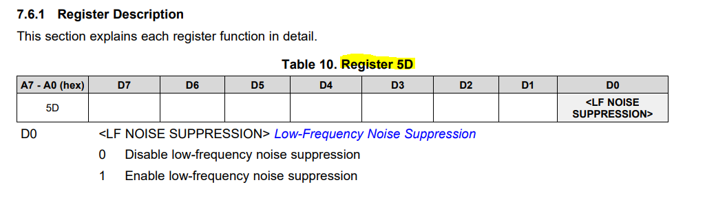

  • Kenjiro,
    To answer your question the device has a pipeline architecture without interleaving. The noise you see at 40 MHz is probably because low frequency noise correction is possibly enabled (see section 7.3.1 Low-Frequency Noise Suppression, page 26 of the datasheet). Then I have two suggestions for you to try.
    1. Try experimenting with the low-frequency noise suppression feature by enabling the bit in the register shown in the image below.
    2. Another suggestion would be to try and low frequency sine wave instead of a DC and see if the results are as expected.
    Yusuf
