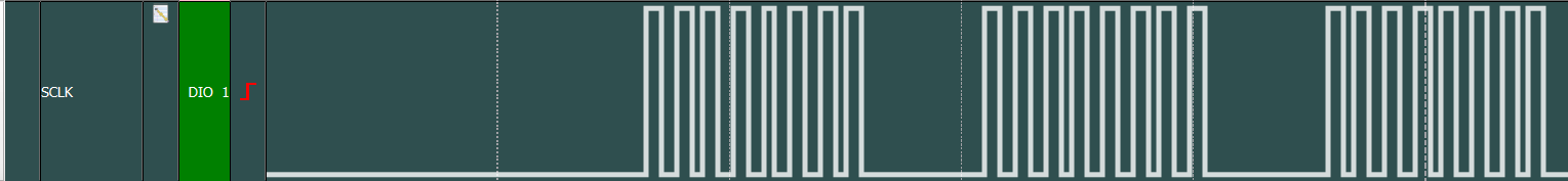

I'm just trying to replace the MMB0 board with an external power source.
Normally the evaluation board starts pulsing at DRDY, as described in the datasheet, when I use the MMB0 board. However, if I use an external power supply (5V, 3.3V and 1.8V (I know, not absolutely necessary)), DRDY is always HIGH... What could be the reason? Does the MMB0 board do anything else, except the power supply, if I only use the barrel jack?
The test points all have the correct voltages according to the data sheet...
I know that DRDY has to pulsate to communicate with the ADS1299.
