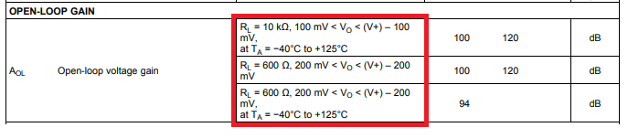

    Section 3.7.1 of the OPA365 datasheet describes the input range of the opamp... The input-common mode voltage is able to slightly exceed the supply rails; however, the output range is still limited.
    One really key detail to pay attention to which any op-amp datasheet, is the test conditions under which the open-loop gain of the opamp was tested...
    This input range tells you that the open-loop gain of the op-amp remains high as long as the output voltage remains 100-200 mV away from either supply rail. Therefore, the opamp will behave linearly within this range!
    The "output swing to rail" specification only tells you at what voltage the op-amp output will fully saturate. In the case of the OPA365, it's output can drive to about 10mV from either supply, but between 10mV and 100mV the op amp is partially saturated and you shouldn't expect it to be linear.
