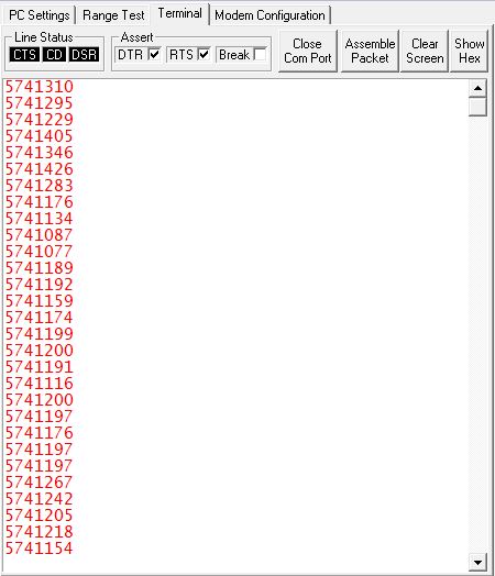

ADS1220 is not sending proper data in continuous mode
Part Number: ADS1220
Sir
I am new to ADS1220.
In Single shot conversion it provide me good data that i want.When i switch to continous mode it will provide me random values.
I dont understand how RDATA command in ADS1220 and also provide DRDY pin used to acess data in continous mode.
Here is the code:

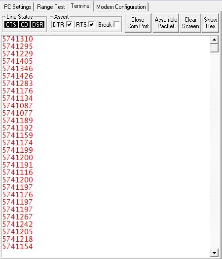

ALso picture conitnous data:
Here is Data look like continous mode:
Here image of single shot mode .is it possible to make single shot mode to continuous mode using START cmd again and again.
Please Help out this problem as soon as possible,
Please me out understand this problem

  • Hi Pranav,
    It appears you are bit-banging the GPIO port to communicate with the ADS1220.  When running in continuous mode you either have to read the data out completely between conversions or you need to use the RDATA command.  The advantage of the RDATA command is that the output buffer will not be automatically updated when a new conversion completes.
    I suspect that you are getting data corruption in continuous mode because you are reading the data and a new conversion completes in the middle of your read of results.  If you attach your Saleae file of the continuous mode I can verify if that is the case.
    The way your code is structured it may be best and easiest to run in single-shot mode.  As soon as the data are read you can issue another start.  In that way can can control when you read from the device and when you start a conversion.
    Bob B
  • Hi Pranav,
    I see that you rejected my answer, so perhaps I need more information and specific details regarding what you are attempting to accomplish.  If you wish to run in continuous mode, you must either read the data results directly and completely before the next DRDY transition to capture every conversion.  If you are not able to do so, then you must issue the RDATA command or you risk having corrupted data.
    There is example code using a micro with an SPI peripheral that can be downloaded.
    http://www.ti.com/lit/zip/SBAC227
    Bob B
