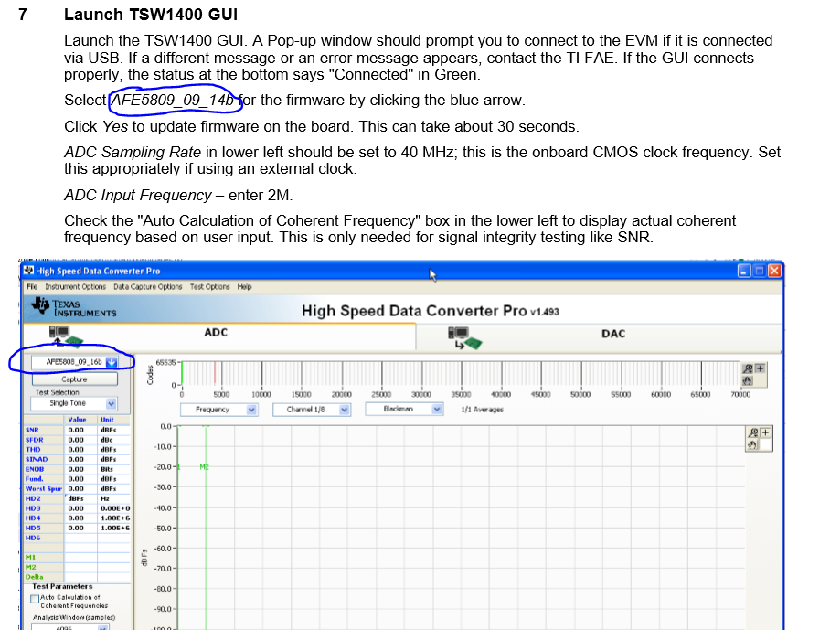

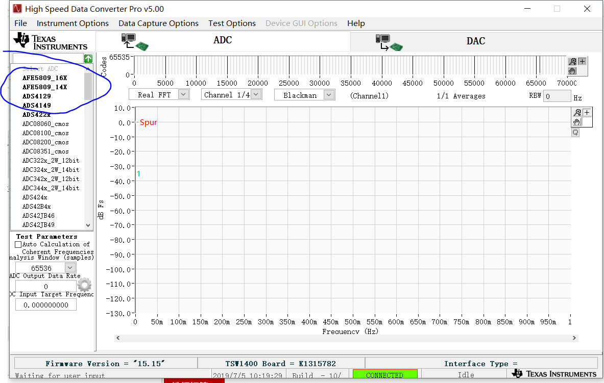

Customers are using AFE5809 with TSW1400.They have the following questions:
The''Select ADC''drop-down list on the left side of TSW1400 GUI cannot find the AFE5809_09_14b mentioned in the AFE5809EVM Evaluation Module user's guide. Only AFE5809_16x, AFE5809_14x and AFE5809_12x.Could you give some suggestions to customers?
