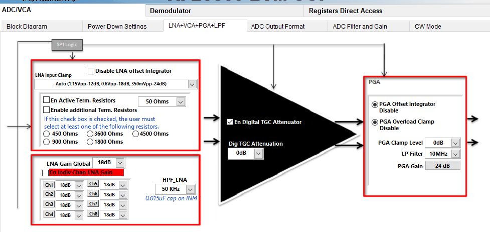

First image, check En digital TGC Attenuator, PGA offset integrator disabe, PGA overload clam disable, HPF_LNA 50 KHz, LNA gain global 18 dB

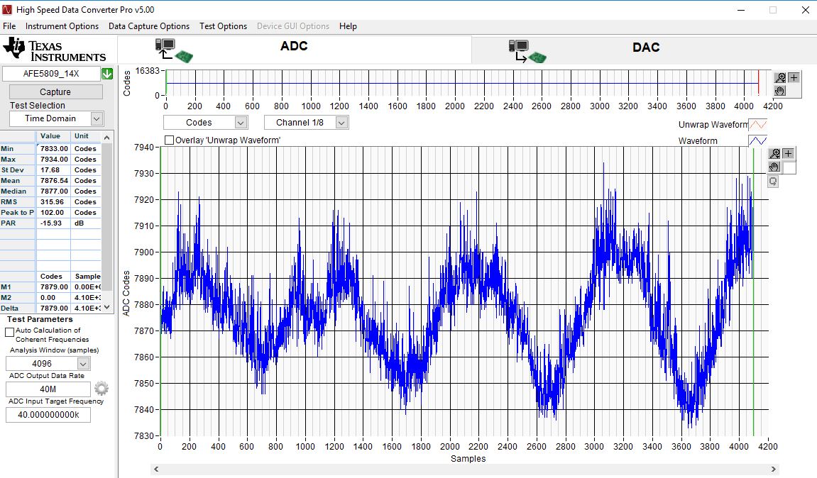

Finally, and apologizing beforehand, please help me if I am correct with my settings or what I did wrong, as you can see when making the continuous capture I am receiving a lot of noise, unwanted signals and I can not perceive or see the pulses of echo that should see.

  • This noise is very low. Vpp is only 80 ADC LSBs, 80/16000 is very very small. you have some low freq noise due to connection or something.
    please check with scope on the AFe input for pulse. Then you will need to use TX_TRIG to sync the capture.

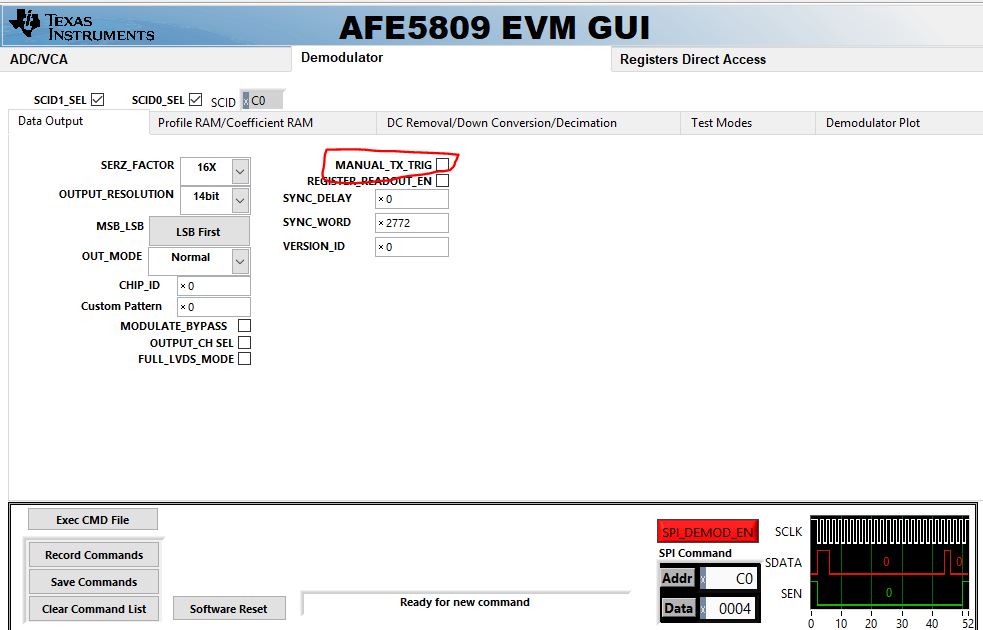

      + Now that you mentioned the use of the TX_TRIG to synchronize both evaluation modules, is this trigger configured only in the AFE5809evm? I have also read in section 8.6.2 Digital demodulator register description that the MANUAL_TX_TRIG must be checked for this event to occur. I attached a screenshot of the gui where it should be checked, but a problem occurs is that not marked this option.

  • based on your configuraiton, you haven't entered the demod mode. you just use the ADC now.
    So you can use the TSW1400 to generate the Trig signal for TX_TRIG input at AFE5809 EVM. please refer to the user manual for TSW1400 configruaiton in the Trig mode.

  • first of all. it is not quite easy for others to locate your setting problem based on these pictures you gave, because there are too many setting options on the GUI.
    the demod stage CAN be deactivated on the GUI, I guess it is the "en demod after enter demod tap".
    your signal frequency and your settings can both result in a capturing failure for u, so I suggest you to check the problem source one by one. First you can test your settings by feeding a 500kHz signal. deactive the demod stage, and see if you can get reasonable results.
    after that, you can enable the demod stage, but, you check the Modulate_Bypass, DC REMOVEAL, DOWN CONV,DECIMATION BYPASS option, and test the OUTPUT CHANNEL SELECT option, to see if you can get right results that is the same with the datasheet.
    then you can test DOWN_CONV_bypass and DECIMATION BYPASS options
    after you have passed all these tests ,i guess you can have a good understanding about these settins, then you can do the M=4 I/Q test.
    one thing you have to check is the downconv frequency in the M=4 mode,

    if your input frequency is 40k, and DHFP = 1, fcs = 450k , then all your signal will be filtered out.
    after you have passed the M=4 teset mode, then you can change your signal to 40kHz, AND MAKE SOME MODIFICATIONS TO THE .TXT FILE, and see what you get.
