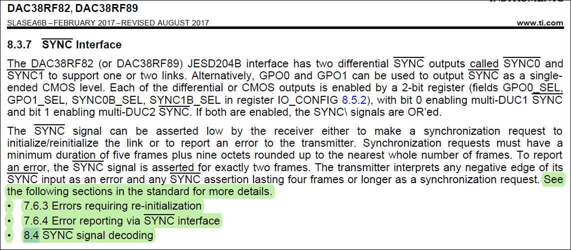

Hello Team,
may I kindly ask you where to find the highlighted, referenced chapters, please? I cannot find them in the JEDEC JESD204C standard.
Thanks and Best Regards, Hans
