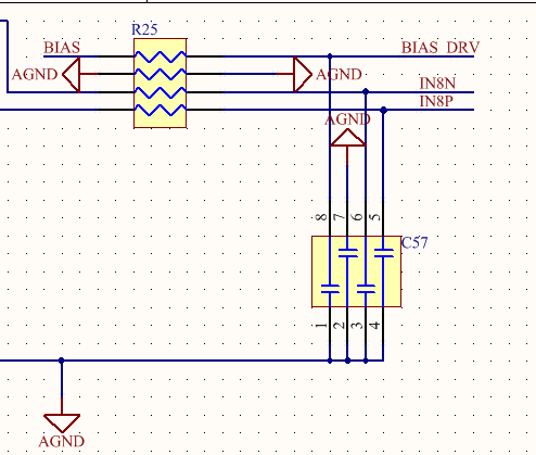

  hi,Right now I am working on a project using ADS1299 with sequential montage for data acquisition. I have some question:
  Schematic description:
Power supply:(AVSS -2.5V,AVDD 2.5V DVDD= 3.3V, LiBattery)
Register configuration table

hardware configuration:Sequential  Montage (SRB2 connect to The earlobe electrode,BIAS connect to another earlobe electrode 1N--8N connect to Brain scalp electrode,1P--8P  float,no connection ,SRB1float,no connection

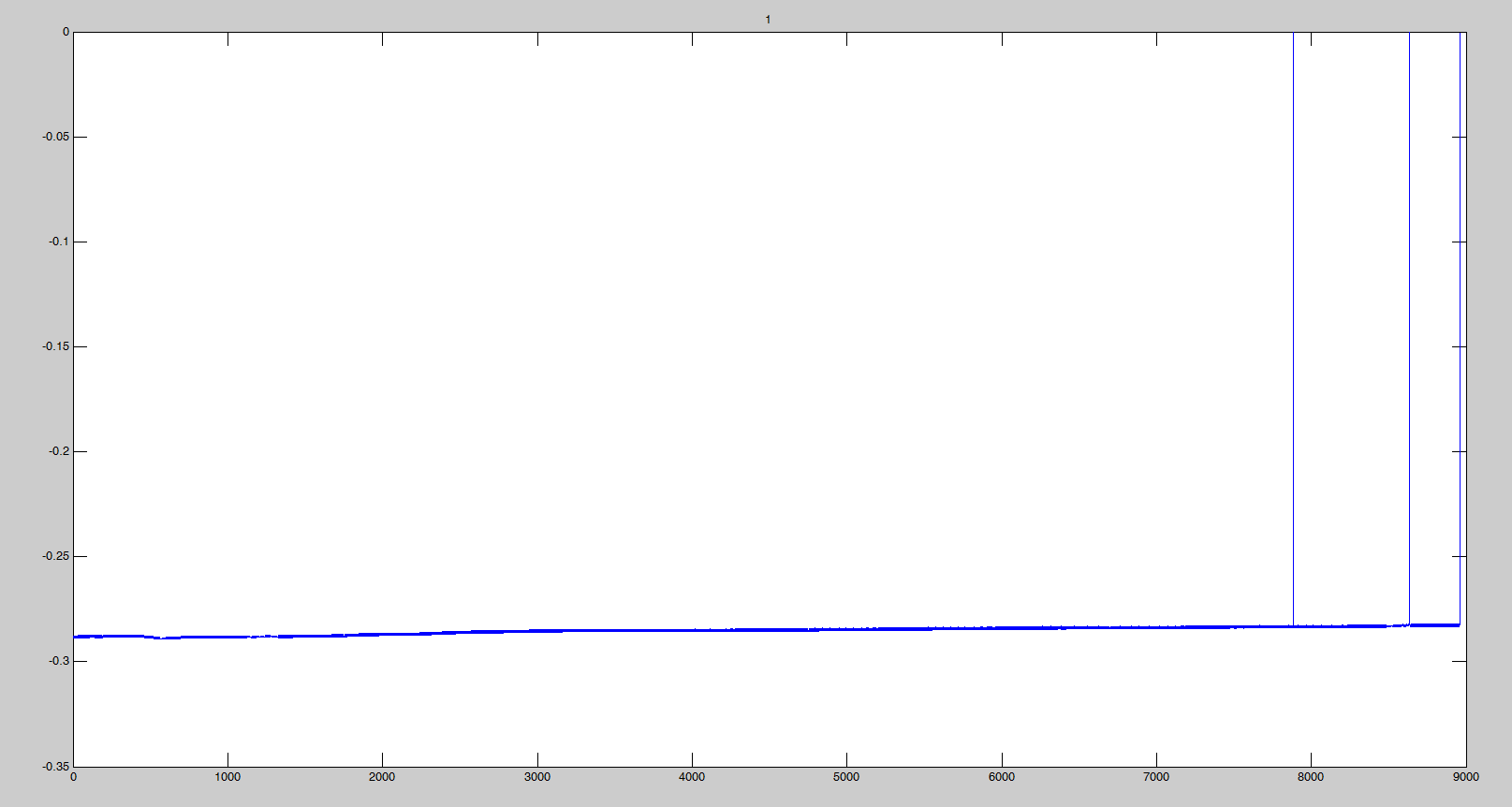

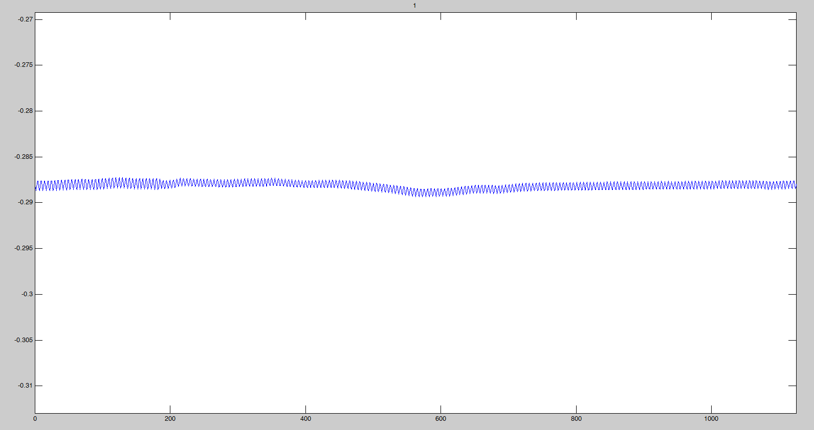

 wave:
wave:X : point    Y:  uV
   I want to make sure that my hardware circuit design is correct and my software configuration is correct?
   Help me to check whether the hardware design of BIAS part is correct?
wave part :Why is the base drift so serious ? The valur are incorrect!
Could you please help me find out what the problem is?
    thanks a lot!!

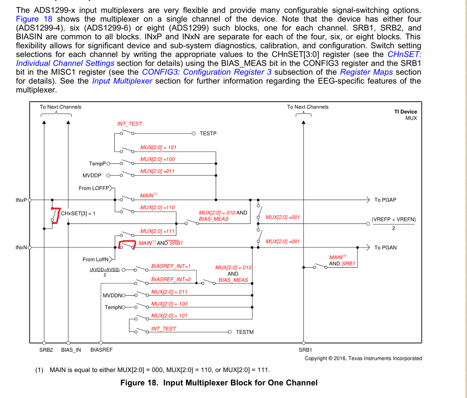

    Thanks for your post and welcome to the forum!
    Looking at your register settings, I see a few issues.
    Channel 1 is the only channel that is in normal operation. All other channels, 2-8, are powered down but they are still configured as a normal electrode input. Looking at pg 50 of the datasheet CHnSET register, you will see that it is recommended to set the channel input to input shorted when the channel is powered down. As it currently is configured, the input is powered down but the inputs are floating. This becomes an issue when you have every channel connected to SRB2. Right now you have 1 channel providing a meaningful measurement to SRB2 and 7 floating inputs.
    Try reading a known input like a sine wave from a signal generator, make sure it's correct, then add more complex measurements as you go.
