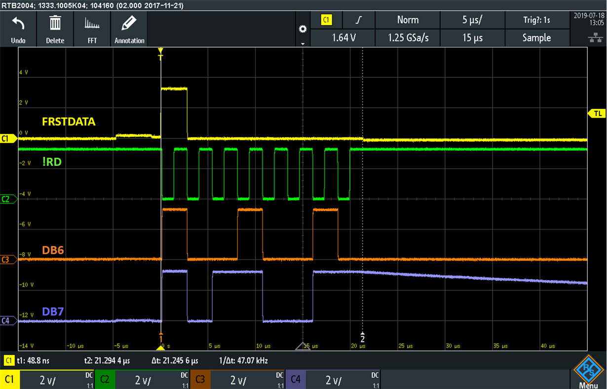

There's an issue during Data Read / Convert so the ADC sends out wrong digital values.
The ADC operates in 5 V-Range, simultaneous sampling on all input channels, parallel data read, external 2,5V-REF, no oversampling.
From Analog-Input-Range 0 V to 1,24 V the converted voltages are correct.
From 1,25 V to 2,4 V the digital voltages are higher by an offset of +2,5 V as they should be.
From 2,5 V to 3,75 V the digital voltages are higher by an offset of +1,25 V as they should be.
From 3,75 V to 5 V (PSR) the voltages are correct again.

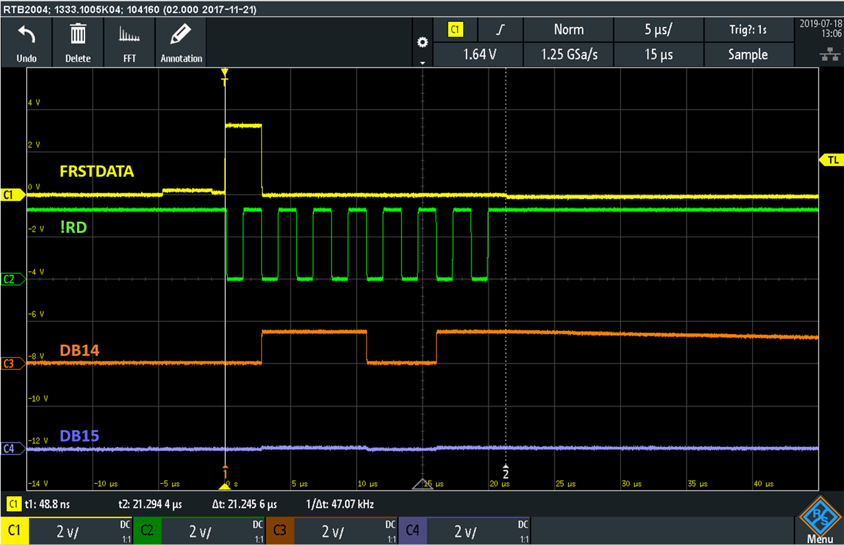

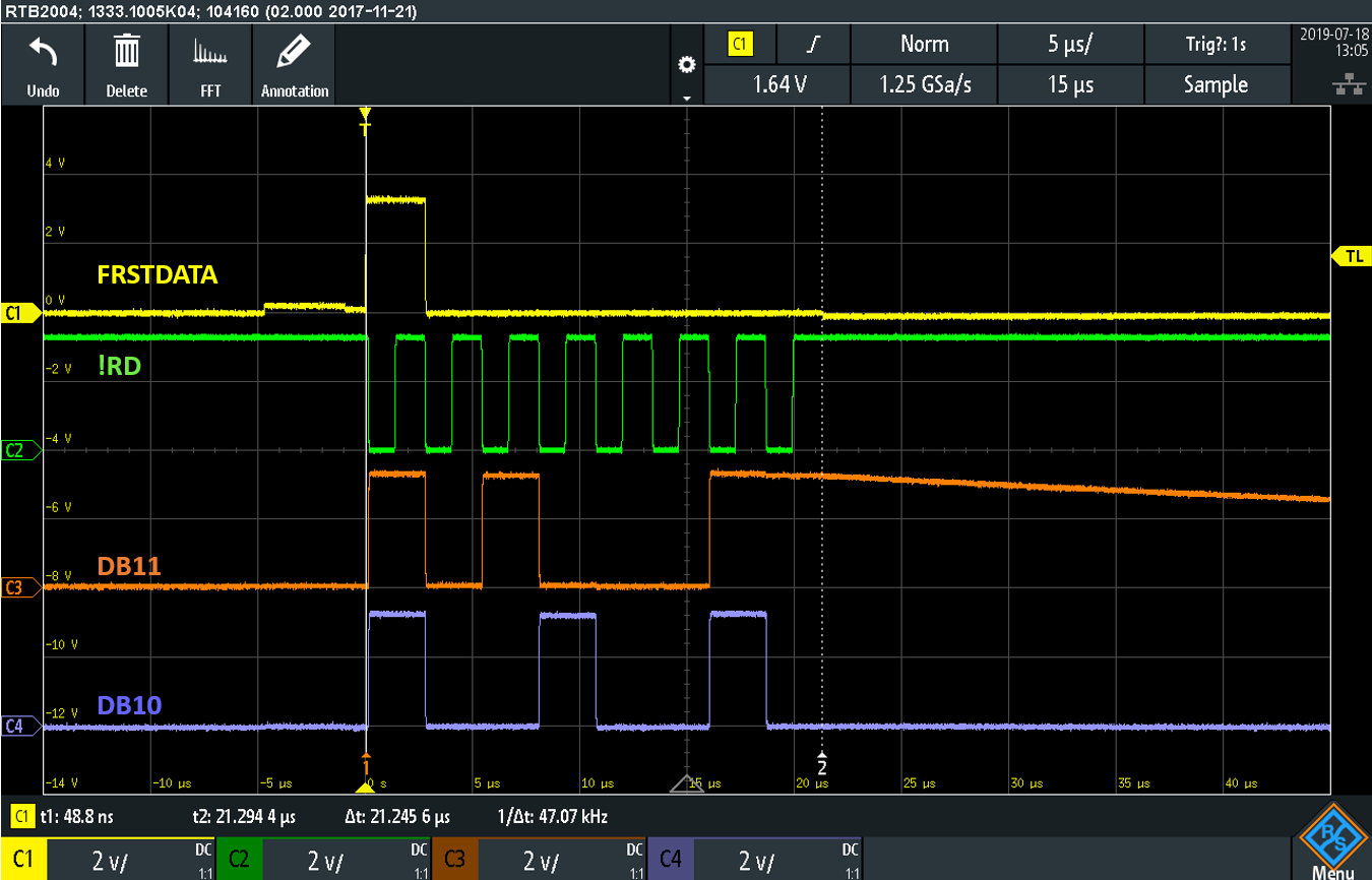

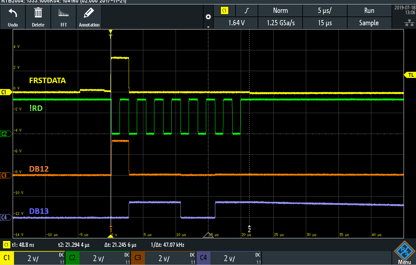

I've checked the Bits [DB15:0] with a logic analyzer, so my interpretation of the values has to be correct.
Do you have any Idea why the ADC is acting like that?

    would you please share the scope shot/logic analyzer shots showing this behavior? And also the schematic, I would like to verify the input is being driven correctly.
    It looks like there is an issue reading the MSB. In the scope shot, include the digital communications to make sure the timing is correct.
    If you look at the correct expected input and what you are seeing, there is a pattern.
    Input             Correct                                                  Customer
    1.24              0011 1111 0111 1101                     0011 1111 0111 1101
    1.25              0011 0011 0011 0011                     1100 0000 0000 0000
    2            0110 0110 0110 0110                     1110 0110 0110 0110
    2.4                0111 1010 1110 0001                     1111 1010 1110 0001
    2.5                1000 0000 0000 0000                     1100 0000 0000 0000
    3                   1001 1001 1001 1010                     1101 1001 1001 1010
    3.75              1100 0000 0000 0000                     1100 0000 0000 0000
    Cynthia

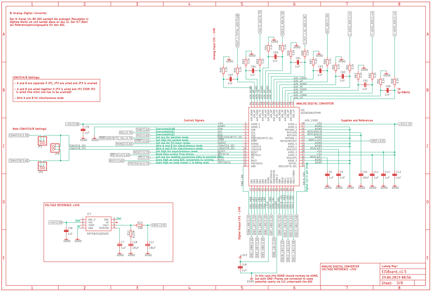

  • Hello Cynthia,
    Thanks for your answer!
    Here you can see the schematic:
    - Only the REFSEL-Pin is hard-wired to GND
    - OS[2:0] are pulled to low via uC (no oversampling)
    - !PAR/SER/BYTE_SEL is pulled to low via uC (parallel data read)
    - !STBY is pulled up via uC (always on)
    - RANGE is pulled low via uC for 5V-Range
    - CONVSTA and CONVSTB are tied together and are code-controlled
    - !RD and !CS are seperate and code-controlled
    - RESET is code-controlled

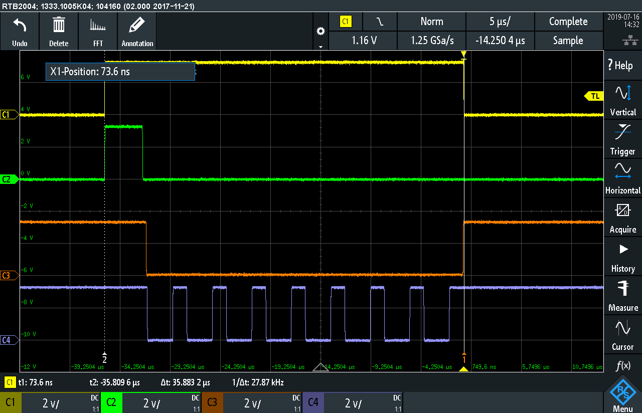

    For the uC i'm using a STM32F446, coding is in C with ARM Keil Compiler. I've attached the Source-Code at the end  (ADC-Functions are marked bold).

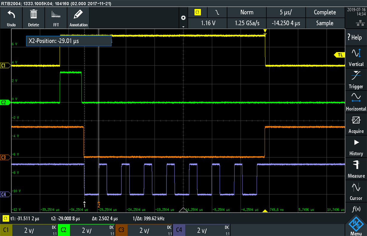

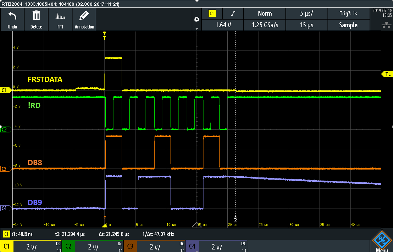

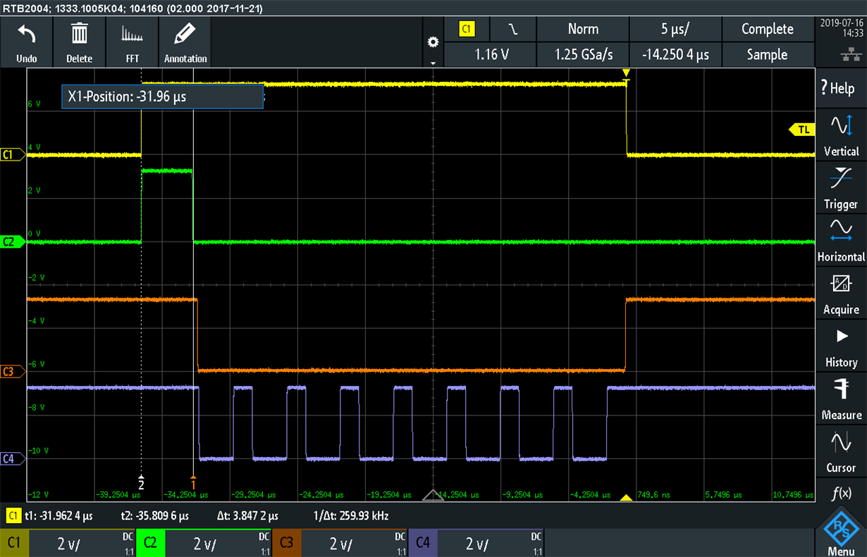

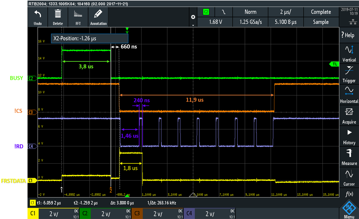

    There's an scope shot of the control timings (not in picture: CONVSTA/B-Signal: it goes on high immediately befor BUSY goes high, and goes back to low if !CS is going back to high):

  • I'm sorry the picture want send.
  • Hello Cynthia,
    unfortunately i only have a 4 channel oscilloscope so i had to split the signals. First of all, again the control signals with timings:
    CONVSTA/B (yellow):
    BUSY (green):
    Delay BUSY falling edge to !CS falling edge (orange):
    Delay !CS falling edge to !RD falling edge (blue):
    Low Time !RD:
    High Time !RD:
    Are these timings correct? I've always put delays in the code to make sure i follow the min. requirements given from data sheet.
    The following scope shots are showing the data bits from DB15 to DB6, DB5 - DB4 are unrelevant so far i think:
    The actual analog input voltages are:
    CH1: 1,24 V
    CH2: 1,26 V
    CH3: 1,65 V
    CH4: 1,52 V
    CH5: 0 V
    CH6: 0 V
    CH7: 1,56 V
    CH8: 1,65 V
    I'm not sure from where the issue is coming from. Could be a timing-issue but also as well a wrong data interpretation / data read in C-code. There is often DB14 and DB13 set where it shouldn't be, as you already sad - there is a pattern.
