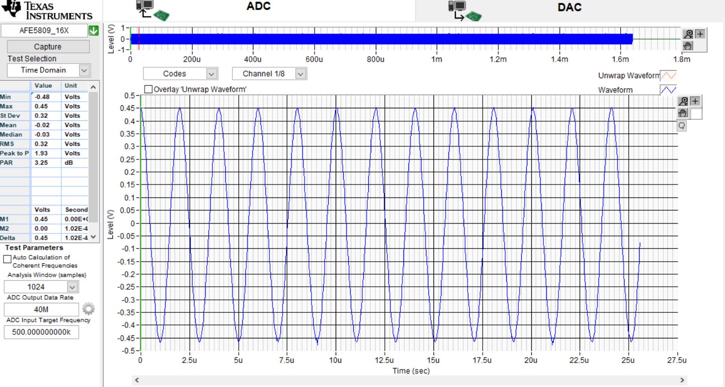

Hi guys,
I have a basic query, I am testing the module in discussion, I attached some screenshots where we can see that when the DIG_DEMODULATOR is checked, the ADC module works normally, on the other hand unchecked DIG_DEMODULATOR we can see that the signal dies and becomes - 1, if someone can get me this doubt?, since I am slowly getting acquainted with this.

    please refer to EVM user manual. When you run the demod test, you will need to apply a trig on TX_TRIG pin and also do extra steps for post-processing the captured data.
    starting fro Page 11. user guide

  • I really appreciate your answer, but still unclear, I am only asking why this happen when I unchecked the box DIG_DEMODULATOR.

  • Digital demodulator is a seperate block. when it is on, we need to issue a TX_TRIG to make sure all Demod settiing are applied to the digital block. it is highlighted in the datsheet as below Page 72.
    NOTE TI recommends to program the profile and filter RAMs before configuring other registers.
    A trigger is required to make new settings effective, such as profile RAM, coefficient RAM, and PROFILE_INDX Reg.0x0E[15:11] —either an external trigger event through the TX_SYNC_IN pin or a manual trigger event through Register 0[2].
    PROFILE_INDX Reg.0x0E[15:11] must be reprogrammed to ensure new profile and filter RAMs loaded correctly.
    ADC CLK is required during profile and coefficent RAM programming.
