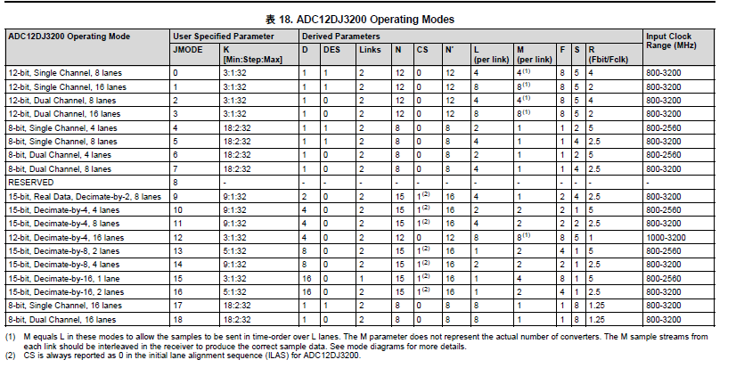

Hello Team,
Customers intend to use ADC12DJ3200. In its datasheet, there is a calculation method about sysref, but there is no calculation method about lane rate. And lane rate is an important parameter of using JESD 204B IP core. Customers do not understand the method of calculating lane rate in TI training video:http://edu.21ic.com/video/1781 I'm not familiar with this part either.
For example, DAC CLK is 2 GHZ, sampling rate is 4 GHZ, using JMODE0, So how to calculate lane rate of ADC of JESD204B interface? Can anyone calculate it with this example? Thank you in advance.
