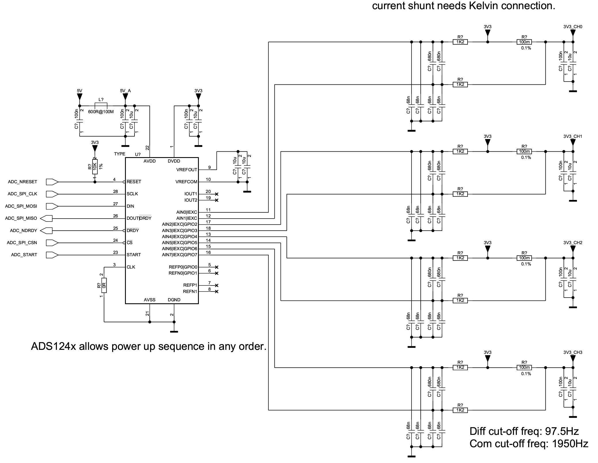

I'm planning to use ADS1248 as the high side current sensing of multiple channels of 3.3V voltage supplies. The schematic is shown as below.
The range of the current is 0~600mA. (single direction), the desired sampling frequency is >=200Hz.
The filters are designed to suit this sampling frequency. The input low pass filter uses 1.2Kohm resistor, as the datasheet recommends <10kOhm.
I'm planning to use a PGA gain of 32, so for 0.1Ohm sensing resistor, the full scale input current range is -640~+640mA.
The AVDD of ADS1248 is supplied with 5V. According to the calculation, the allowable common mode voltage range is 1.124V ~ 3.876V, so 3.3V won't exceed this range.
Most of the reference circuit of ADS1248 is for RTD temperature measurement so I've never seen a similar current measurement circuit before.
So Please help me check if this circuit can work as desired.
Any other recommendation on improving performance and reliability (such as PCB layout considerations, ESD protection measures) are welcomed.
Thanks for the help!!

  • Hi Shan,
    Thanks for your post and welcome to the forum!
    I don't see anything wrong with the measurement. I do have a few other comments though.
    I recommend removing the inductor from the 5V AVDD supply. We've seen issues arise when there is inductance on the supply line when the internal reference is turned on. If you're intended use for this as a filter, a small resistor should suffice.
    In order to save board space, consider removing half of the capacitors for the input filters and doubling the resistance.
    Last but not least, if this is for a new design I encourage you to take a look at the ADS124S08. It's our latest and greatest device for this space and offers better accuracy and resolution compared to ADS1248.
  • Hi, Alex,
    thanks for the quick feedback.
    The said component is a ferrite bead. But I think what you said also applies to ferrite beads too, right?
    What is the value of resistor for the noise blocking? can you suggest one?
    Thanks!
    Shan Song
  • Hi Shan,
    Yes, ferrite beads are similar to inductors so it still applies. The resistor should be just large enough to create a low-pass filter when combined with the decoupling caps, less than 100ohm, 10ohm should be fine. You will want to place the 10u cap close to the source of the power supply and the 100n cap as close as possible to the device pin.
