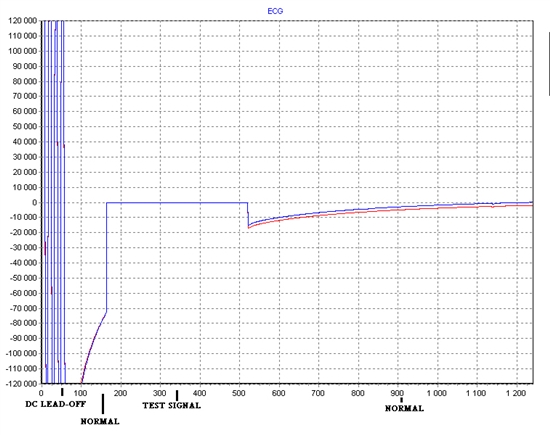

Hello, everyone!
I'm try to use DC Lead-off method in my ADS1298. Here is my sample code:

It's work! I can really detect if electode is off. But when i switch eletrodes to normal mode i see long transient:
On picture - red line - right hand, blue line - chest 1. DC lead-off repeats 8 times switching LOFF_FLIP.
I have to wait much time before i can measure ECG signal! And time of transient process differs for different people!
Is there any ways to stop drift and fast normalize signal ?
Thanks in advance
  • Hi Mikhail,
    The ADS1298 takes 3 x tDR to settle with a step change input, which is essentially what you have in a lead off condition.  What is the sample rate you have set up for the ADS1298?  What are the units on the X axis of your graph?  Please note that the ADS1298EVM is not intended to be connected to anything other than an ECG simulator.
